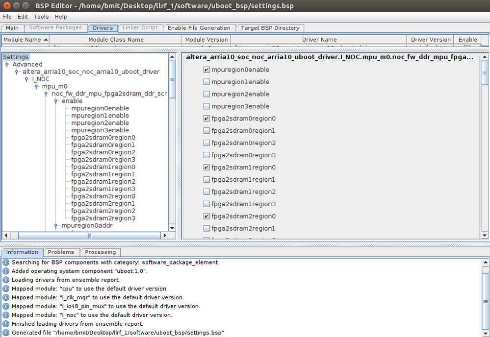

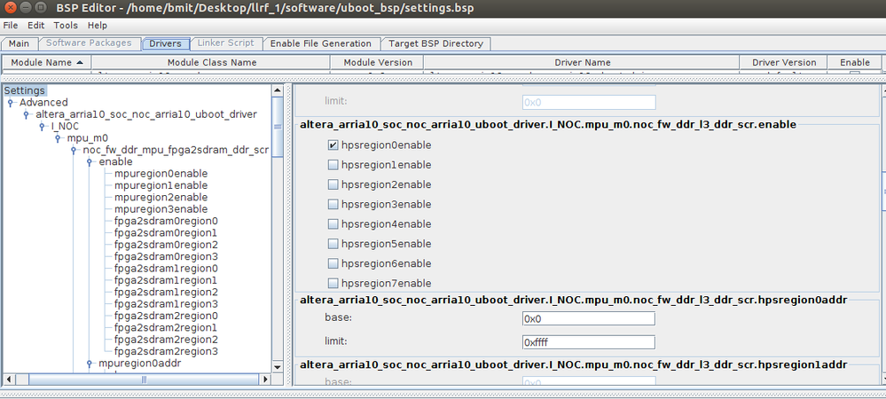

- PJais1
I am also building Linux OS for our custom board which took reference from Arria 10 .
I have designed the uboot_mkpimage.bin file and uploaded it in SD Card by taking reference from below links but I am unable to boot the system
https://rocketboards.org/foswiki/Documentation/A10GSRDGeneratingUBootAndUBootDeviceTree
https://rocketboards.org/foswiki/Documentation/A10GSRDCreatingAndUpdatingTheSDCardLTS
In our custom I did the following changes:
1. Replaced DDR4 memory with DDR3 memory at HPS side.
2. Selected UART1 as debug port and connected both UART0 and UART1 interface to HPS.
3. Connected SDMMC for booting at HPS Dedicated Bank.
For the above changes ,I modified ghrd_10AS066N3F40.qsys design which was downloaded from
https://rocketboards.org/foswiki/Documentation/GSRDTagging#Release_binaries .
In the platform designer tool I removed subsystem.qsys file ,which was causing IP license error.This is used for video processing and not required for our project. After applying all the above changes in qsys file , I modified the top.v file and did pin assignment and generated .sof file and handoff folder.
For generating uboot image I am using bsp-editor, but unable to understand the changes which we need to apply in uboot drivers in bsp editor. The attachment contains the bsp-editor image in which modification is required.
For using UART1 as console , we have modified socfpga_arria10.h with following changes-
#define CONFIG_BOOTARGS “console=ttyS1,” __stringify(CONFIG_BAUDRATE)
#define CONFIG_SYS_NS16550_COM1 SOCFPGA_UART1_ADDRESS
Please help with the above query. Also, Are there any further modification we need to do in generated files for above hardware changes?
