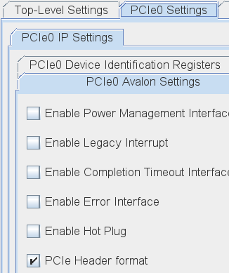

      R-Tile is configured with the ' PCIe Header format' enabled :
      Can you confirm me the mapping to use with the following signals :
      st0_hdr(31:0) <= 01000040h – Memory write 32-Bits command=40h, Length=(7:0)=01h => 1DW
      st0_hdr(63:32) <= 0Fh & 000PORT_TAG_NB(5:0) & 0000h - TAG, LAST_BE=0h, First_BE=Fh, Requester_ID=0h
      st0_hdr(95:64) <= (BASE_ADD_EP + 14h) – Add Reg – Address(31:0)
      st0_hdr(127:96) <= 00000000h - Reserved
      If this mapping is not correct please write the correct one.
      Thank you.

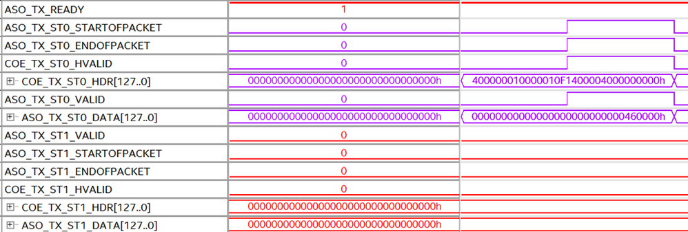

      Can you check this write access :
      It is supposed to be a Memory Write at address 40000014h of 1DW with the value 00460000h
      The Completion is an Error Message IRQ code 31h :
      Thank you.
      Serge

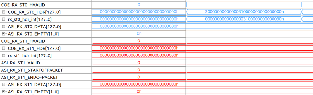

  • Hi Serge,
    Not sure I understand those signals. You're using Gen2 x2 and rx_st0_hdr_int data is not correct, is that your question?
    Rong

  • 2) Can you detail what you mean by the PCIe Command Register ? What address ? in Root Port or in Target ?
    -->PCIe configuration space offset 0x4. Check RP side. Bit 1 is for Memory Space Enable.
    Rong
