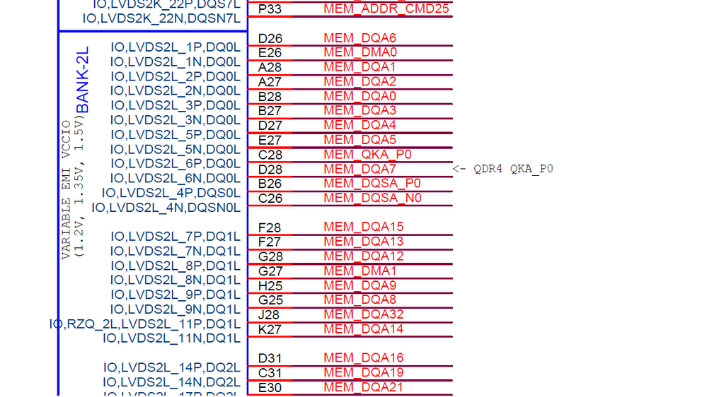

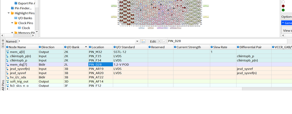

Dear Support/Expert,
While I am leaning how to compile a DDR4 with Quartus Pro.
I got a message
Error(175011): Conflicting region assignments found for DQ_GRP, which is within External Memory Interfaces Intel Arria 10 FPGA IP jesd204b_emif_0_altera_emif_1920_n6nqnfq.
After I comment out most of the pin assignment, I find the problem is
set_location_assignment PIN_D28 -to mem_dq[7].
on the Arria 10X dev board, the Mem_dq[7] must be on D28.
and it is the only pin on bank 2L. I don't know what I can do to over come this problem.
Please give me some suggestion. appreciate your help.
David

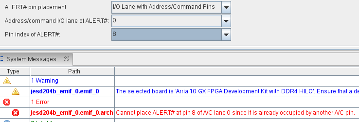

    • dsun01's avatar
      dsun01
      Hi Adzim,
      on the Intel A10 GX dev board, the ALERT pin from Hilo memory card is physically connected to Arria 10 Pin E35. so I don't think use other pins is an option.
      I create a new IP from scratch by using presets for emif_0 Arria 10 GX FPGA Development Kit with DDR4 HILO. there should not have any other assignment.
      why it report
      Error: emif_0.arch: Cannot place ALERT# at pin 8 of A/C lane 0 since it is already occupied by another A/C pin.
      to isolate the possible wrong assignment or resource conflict in my project. why the original Intel preset IP still have the Alter# error. I think alter# has to be assigned to E35.
      thank you,

    • dsun01's avatar
      dsun01
      Hi Adzim,
      Now I have another headache. the whole project I am porting to the Intel A10 GX dev board is based on 64 bit DDR4.
      if I use the preset DDR4 HiLO 72 bits, then I have to change all the MM bus of the project from 512 to 576( DDR X 8).
      if I change preset DDR4 HiLO to 64 bits, then the Alert# won't be able to assign to Pin_E35. I am not that familiar with the DDR4 standard, is this Alert# very critical? can I ignore it when prototype with the Dev Kit, and make the fix in the final production board design?
      thank you,
      David
  • AdzimZM_Altera's avatar
    AdzimZM_Altera
    Hi David,
    I'm really sorry because it's my fault to judge the pin location for pin E35.
    The pin E35 is not in lane 0 index 8, but it is in lane 3 index 0.
    I've referred to the Arria 10 Pin-Out file to confirm the pin location.
    I also have applied the changes into your project and it's working.
    Here are some steps that you can follow:
    1. Change the following setting: (The changes is in EMIF IP in the Memory tab under the Topology section)
      • ALERT# pin placement: I/O Lane with Address/Command Pins
      • Address/command I/O lane of ALERT#: 3
      • Pin index of ALERT#: 0
    2. Save and regenerate your EMIF IP.
    3. Enable the mem_alert_n pin location to pin E35. (if you enable it through .qsf file, you need to restart the Quartus software)
    4. Compile the project.
    I hope you're able to make it from your site.
    Please let me know if you still need help on this.
    Adzim
