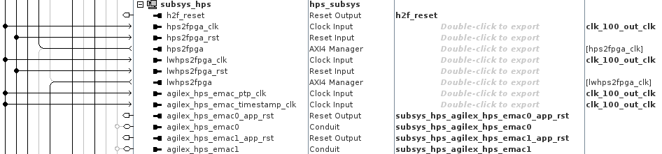

I am trying to ping one EMAC from another, and have instantiated the following in the HPS:
These are exported to the top level, then connected as followed:
// https://www.intel.com/content/www/us/en/docs/programmable/814346/25-1/fpga-emac-i-o-signals.html module dual_emac_interface ( input wire clk, input wire rst_n, // EMAC0 Signals input wire emac0_app_rst_reset_n_wire, output wire emac0_mac_tx_clk_o_wire, // not used in 10/100 Mbps input wire emac0_mac_tx_clk_i_wire, // not used in 1/2.5 Gbps input wire emac0_mac_rx_clk_wire, output wire emac0_mac_rst_tx_n_wire, // (unused) reset for tx path output wire emac0_mac_rst_rx_n_wire, // (unused) reset for rx path output wire emac0_mac_txen_wire, output wire emac0_mac_txer_wire, input wire emac0_mac_rxdv_wire, input wire emac0_mac_rxer_wire, input wire [7:0] emac0_mac_rxd_wire, // for 10/100 Mbps designs, only bits [3:0] are used input wire emac0_mac_col_wire, // valid only when operating in half duplex input wire emac0_mac_crs_wire, output wire [2:0] emac0_mac_speed_wire, // set to 3'b011 for 1 Gbps (125 MHz) output wire [7:0] emac0_mac_txd_o_wire, // for 10/100 Mbps designs, only bits [3:0] are used // EMAC1 Signals input wire emac1_app_rst_reset_n_wire, output wire emac1_mac_tx_clk_o_wire, input wire emac1_mac_tx_clk_i_wire, input wire emac1_mac_rx_clk_wire, output wire emac1_mac_rst_tx_n_wire, output wire emac1_mac_rst_rx_n_wire, output wire emac1_mac_txen_wire, output wire emac1_mac_txer_wire, input wire emac1_mac_rxdv_wire, input wire emac1_mac_rxer_wire, input wire [7:0] emac1_mac_rxd_wire, input wire emac1_mac_col_wire, input wire emac1_mac_crs_wire, input wire [2:0] emac1_mac_speed_wire, output wire [7:0] emac1_mac_txd_o_wire ); assign emac0_app_rst_reset_n_wire = rst_n; //assign emac0_mac_tx_clk_i_wire = clk; assign emac0_mac_rx_clk_wire = emac1_mac_tx_clk_o_wire; //rxclk0=txclk1 assign emac0_mac_rxdv_wire = 1'b1; //valid held high assign emac0_mac_rxer_wire = emac1_mac_txer_wire; //rx0err=tx1err assign emac0_mac_rxd_wire = emac1_mac_txd_o_wire; //din0=dout1 //assign emac0_mac_col_wire = 1'b0; //full duplex assign emac0_mac_crs_wire = 1'b1; //never idle assign emac1_app_rst_reset_n_wire = rst_n; //assign emac1_mac_tx_clk_i_wire = clk; assign emac1_mac_rx_clk_wire = emac0_mac_tx_clk_o_wire; assign emac1_mac_rxdv_wire = 1'b1; assign emac1_mac_rxer_wire = emac0_mac_txer_wire; assign emac1_mac_rxd_wire = emac0_mac_txd_o_wire; //assign emac1_mac_col_wire = 1'b0; assign emac1_mac_crs_wire = 1'b1; endmodule
In the .dts, I have the following config (based on the dtsi provided by altera
&gmac0 { status = "okay"; phy-mode = "gmii"; fixed-link { speed = <1000>; full-duplex; }; }; &gmac1 { status = "okay"; phy-mode = "gmii"; fixed-link { speed = <1000>; full-duplex; }; };
However, when booting into linux - the drivers appear to be unhappy:
[ 26.367856] socfpga-dwmac 10810000.ethernet: Failed to reset the dma [ 26.374250] socfpga-dwmac 10810000.ethernet eth0: stmmac_hw_setup: DMA engine initialization failed [ 26.383425] socfpga-dwmac 10810000.ethernet eth0: __stmmac_open: Hw setup failed [ 26.588347] socfpga-dwmac 10820000.ethernet: Failed to reset the dma [ 26.594740] socfpga-dwmac 10820000.ethernet eth1: stmmac_hw_setup: DMA engine initialization failed [ 26.603759] socfpga-dwmac 10820000.ethernet eth1: __stmmac_open: Hw setup failed
Anyone maybe know what is the issue?

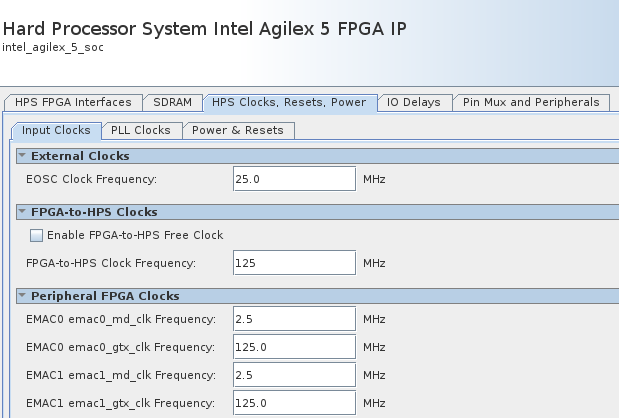

- TiensungA_Altera
On top of what my other colleagues asked, Can you also dump, the boot Linux log for all the lines that mentions "socfpga-dwmac"?

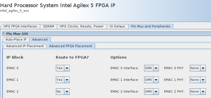

I want to understand if the Hard IP is even accessible or enabled correctly by the Quartus design for Ethernet. The example i have here is for gmac2. But you are using gmac0 and gmac1. It seems you are unable to even perform the initial setup of the ETH HW which has a DMA engine. This requires write to the ETH HW CSR register address.

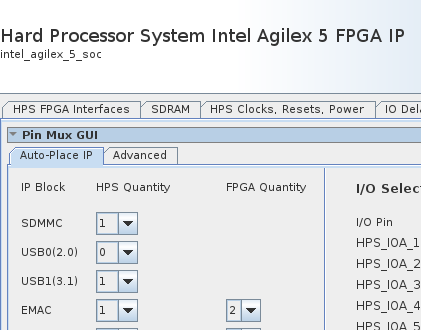

I want to see if the GMAC0 and GMAC1 are even enabled correctly from the Quartus design at the HPS.
In the Quartus HPS config, did you enable GMAC0 and GMAC1 from the dropdowns to select the function?
GMAC0: → [ RGMII ] / [ SGMII ] / [ Disabled ]
GMAC1: → [ RGMII ] / [ SGMII ] / [ Disabled ]This should be propagated as a handoff data to the U-boot HPS FSBL which will configure the PINMUX and also CLK settings. The Handoff is important to the HPS to configure the ETH clock settings and pinmux. The GMAC0 and GMAC1 reset should already been de-asserted by the U-boot during boot-up. So, i don't suspect the reset de-assertion. It is either the CLK or the PINMUX or a combination of both. Without CLK, the IP will be permanently be disabled. CLK is the major suspect.
In short, I suspect that, the GMAC0 and GMAC1 CLK are disabled by a bad Quartus configuration.

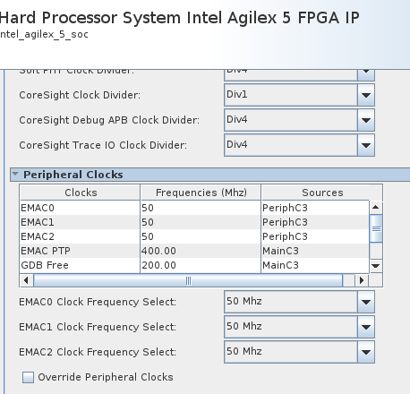

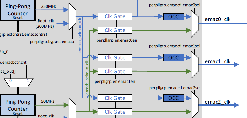

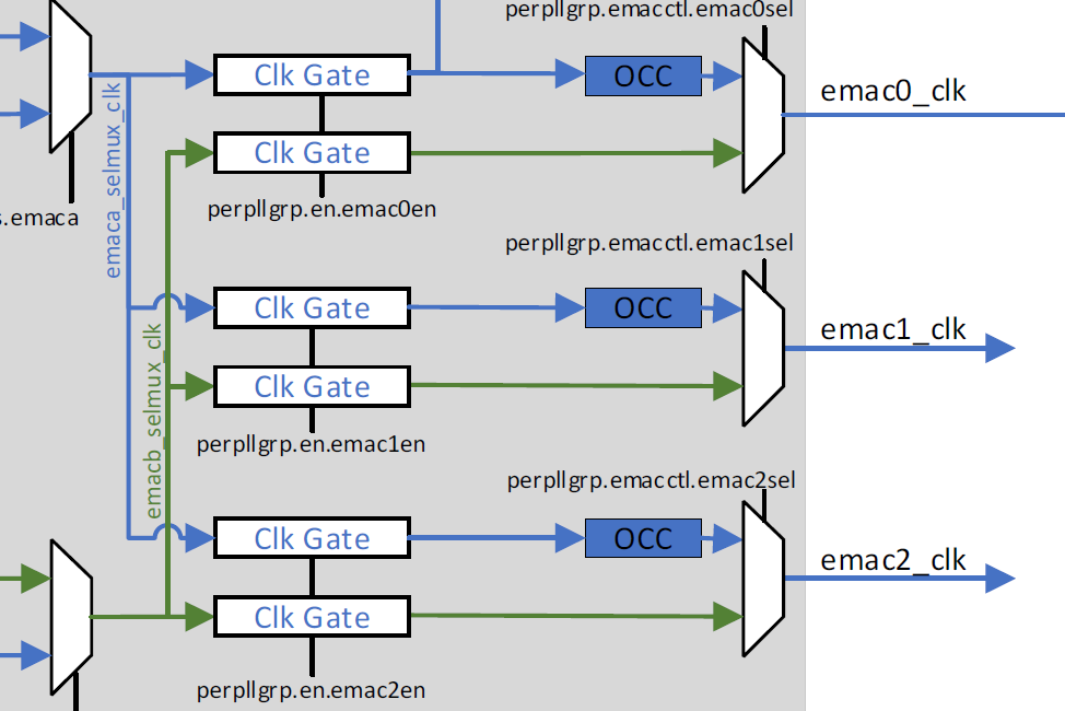

I would be questioning why emac1 and emac0 clk are disabled for some unknown reason. From the CLK dump from Linux, I believed the Quartus design may have an issue.
These 2 clock gates the GMAC0 and GMAC1 (emac0_en , emac1_en). That is why GMAC2 is the only one working. We don't know why yet.
Thanks for all the dumps.
Can you send us the file below? We would need to inspect your SOF file.
XXX.sof

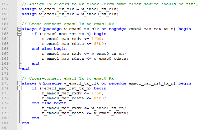

- Sparrow_Altera
Hello K606
As you wait for the sof file analysis to come back, you can check the below information that one of my colleague shared
For a MAC-to-MAC loopback test, it requires additional logic. The main logic that enables this is:
fyi, this code above has not gone thru validation, but my colleague has tested the basic functionalities (ping and iperf transfers).
The DTSI is correct.
But additional kernel option (network namespace) needs to be enabled to ensure the data transfer is not virtual. This is because Linux network stack is pretty intelligent to detect transfer between interfaces on the same host and will attempt SW transfers without going thru MAC.

I also had a look at the snippet you shared, adapting it to my project as followed:
module dual_emac_interface ( // EMAC0 Signals output wire emac0_mac_tx_clk_o_wire, // clock out for tx (not used in 10/100 Mbps) input wire emac0_mac_tx_clk_i_wire, // clock in for tx (not used in 1/2.5 Gbps, but fed signal either way - should be 25MHz) input wire emac0_mac_rx_clk_wire, // clock for rx path output wire emac0_mac_rst_tx_n_wire, // reset for tx path output wire emac0_mac_rst_rx_n_wire, // reset for rx path output wire emac0_mac_txen_wire, // transmit enable signal output wire emac0_mac_txer_wire, // transmit error signal input wire emac0_mac_rxdv_wire, // receive data valid signal input wire emac0_mac_rxer_wire, // receive error signal input wire [7:0] emac0_mac_rxd_wire, // for 10/100 Mbps designs, only bits [3:0] are used input wire emac0_mac_col_wire, // collision signal (half-duplex only) input wire emac0_mac_crs_wire, // carrier sense signal (half-duplex only) output wire [2:0] emac0_mac_speed_wire, // set to 3'b011 for 1 Gbps (125 MHz) output wire [7:0] emac0_mac_txd_o_wire, // for 10/100 Mbps designs, only bits [3:0] are used // EMAC1 Signals output wire emac1_mac_tx_clk_o_wire, input wire emac1_mac_tx_clk_i_wire, input wire emac1_mac_rx_clk_wire, output wire emac1_mac_rst_tx_n_wire, output wire emac1_mac_rst_rx_n_wire, output wire emac1_mac_txen_wire, output wire emac1_mac_txer_wire, input wire emac1_mac_rxdv_wire, input wire emac1_mac_rxer_wire, input wire [7:0] emac1_mac_rxd_wire, input wire emac1_mac_col_wire, input wire emac1_mac_crs_wire, output wire [2:0] emac1_mac_speed_wire, output wire [7:0] emac1_mac_txd_o_wire ); reg emac0_mac_tx_clk_i_reg, emac0_mac_rxer_reg, emac0_mac_rxdv_reg; reg [7:0] emac0_mac_rxd_reg; reg emac1_mac_tx_clk_i_reg, emac1_mac_rxer_reg, emac1_mac_rxdv_reg; reg [7:0] emac1_mac_rxd_reg; assign emac1_mac_tx_clk_i_wire = emac0_mac_tx_clk_o_wire; assign emac1_mac_rx_clk_wire = emac0_mac_tx_clk_o_wire; assign emac1_mac_rxdv_wire = emac1_mac_rxdv_reg; assign emac1_mac_rxer_wire = emac0_mac_txer_wire; assign emac1_mac_rxd_wire = emac1_mac_rxd_reg; assign emac1_mac_col_wire = 1'b0; assign emac1_mac_crs_wire = 1'b1; assign emac1_mac_speed_wire = 3'b011; assign emac0_mac_tx_clk_i_wire = emac1_mac_tx_clk_o_wire; assign emac0_mac_rx_clk_wire = emac1_mac_tx_clk_o_wire; assign emac0_mac_rxdv_wire = emac0_mac_rxdv_reg; assign emac0_mac_rxer_wire = emac1_mac_txer_wire; assign emac0_mac_rxd_wire = emac0_mac_rxd_reg; assign emac0_mac_col_wire = 1'b0; assign emac0_mac_crs_wire = 1'b1; assign emac0_mac_speed_wire = 3'b011; always @ (posedge emac1_mac_tx_clk_o_wire) begin if(!emac1_mac_rst_tx_n_wire) begin emac0_mac_rxdv_reg <= 1'b0; emac0_mac_rxd_reg <= 8'b0; end else begin emac0_mac_rxdv_reg <= emac1_mac_txen_wire; emac0_mac_rxd_reg <= emac1_mac_txd_o_wire; end end always @ (posedge emac0_mac_tx_clk_o_wire) begin if(!emac0_mac_rst_tx_n_wire) begin emac1_mac_rxdv_reg <= 1'b0; emac1_mac_rxd_reg <= 8'b0; end else begin emac1_mac_rxdv_reg <= emac0_mac_txen_wire; emac1_mac_rxd_reg <= emac0_mac_txd_o_wire; end end endmoduleI again found the same initialisation error as here
With the emac clock tree as followed:
$ cat /sys/kernel/debug/clk/clk_summary | grep emac root@localhost:~# cat /sys/kernel/debug/clk/clk_summary | grep emac emaca_free_clk 1 1 0 250000000 0 0 50000 Y emac2_clk 1 1 0 250000000 0 0 50000 Y emac1_clk 0 0 0 250000000 0 0 50000 Y emac0_clk 0 0 0 250000000 0 0 50000 Y emac_ptp_free_clk 1 1 0 400000000 0 0 50000 Y emac_ptp_clk 1 1 0 400000000 0 0 50000 Y i2c_emac2_pclk 0 0 0 100000000 0 0 50000 Y i2c_emac1_pclk 0 0 0 100000000 0 0 50000 Y i2c_emac0_pclk 0 0 0 100000000 0 0 50000 Y emacb_free_clk 0 0 0 70000000 0 0 50000 YMany thanks,
K
