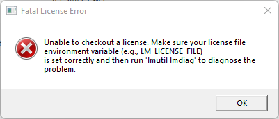

I'm having a similar problem to this post. I generated a license for Questa Starter Edition using the SSLC and set up the LM_LICENSE _FILE environment variable, but Questa will not recognize the license.
When I start Questa, I get the following error:
C:\WINDOWS\system32>vsim
Unable to checkout a license. Make sure your license file environment variable (e.g., LM_LICENSE_FILE) is set correctly and then run 'lmutil lmdiag' to diagnose the problem.
Unable to checkout a license. Vsim is closing.

My license file is similar to the one shown in the post I linked above. I tried generating a new license file, but the format is the same. What can I do to fix this issue?
