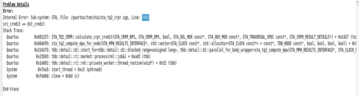

I use QuartusPro25.3 , Device is AGILEX 7  , I found it often report error when in the "retiming " stage,
Sometime I just modify my design to add some debug signal , and it report error ,error massage is as below , Is any one can help , thanks

      This appears less like a true STA issue and more like a Hyper-Retiming sensitivity on Agilex 7, where even a small debug change can affect register movement, especially when tapping F-tile RX status or control signals such as rx_set_locktodata, edp_pll_lock, or rx_is_lockedtoref; the most practical recommendation is to avoid driving the debug bus directly from these raw signals and instead capture registered or synchronized copies first, as this usually helps prevent retiming conflicts, and also perform a clean rebuild to rule out any stale compilation database effects.

    Sorry , I can't attach my design ,sometimes just change some  debug signal and it report error ,
    modify debug signal like below  ( F-tile RX related signal  )
    wire [7:0] DBGO_FPGA_RX_06H = {
      //rx_set_locktodata[1],edp_pll_lock[1],rx_is_lockedtodata_sys1,rx_is_lockedtoref_sys1, //4 bit use  this error
     rx_ready_sys1,rx_ready_sys0,rx_is_lockedtodata_sys1,rx_set_locktodata[0],  //4 bit use this ok
     rx_is_lockedtodata_sys0,rx_reset_ack_sys0,rx_reset_sys0,edp_reset_cdr[0]} ;
    should I update QuatrusPro to 26.1

      Without the design, it will be hard to root cause the problem. Is that fine that you attached the design privately with NDA sign?
