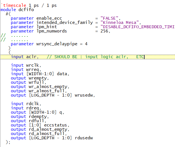

    I suspect the Altera SV code for the fifo isn't optimal (probably missing "logic" in the port declaration).
    Note however that while using `default_nettype none was a recommended practice in Verilog, it has become -alas- a bad idea in SystemVerilog. I suggest you remove it in your (wrapper ?) code.
  • BCuze's avatar
    BCuze
    Yes, that's what I suspected, not very good sv code :-(.
    So make sure you don't use `default_nettype none on your code.
