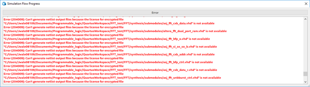

I'm trying to use the University Program VWF to simulate a simple implementation of the FFT IP core. However, when I attempt to run the simulation I get the following errors relating to the sub-modules being encrypted.
Is there a way around this? How do I go about simulating my designs which in include the FFT core?

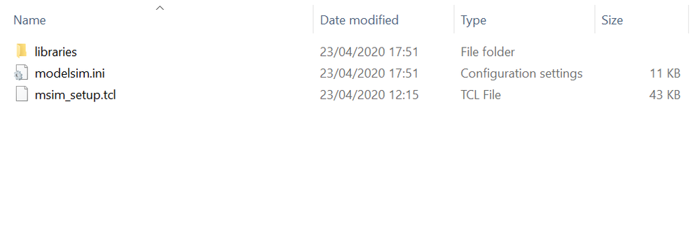

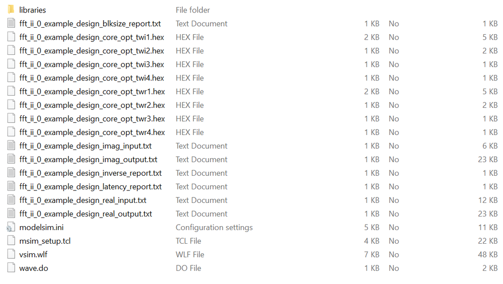

Your example works fine, thanks Chee. Unfortunately, I am still unable to generate examples of my own IP instances. It looks like when I generate the example, I am not creating all the necessary files in the mentor folder?
The file you sent me looks like this
Where as my folder looks like this
Hence my error:
# error copying "./..//../../../../../../../JWALE0~1/AppData/Local/Temp/alt8375_8958432751580048751.dir/0002_fft_ii_0_gen/src/fft_ii_0_example_design_core_1n1024cos.hex": no such file or directory
Maybe I am not generating the example properly to begin with?
- CheepinC_altera
Sorry for any confusion. the ZiP that I sent to your consist of the complete folder after running simulation. The additional files that you are seeing are generated during the simulation.
