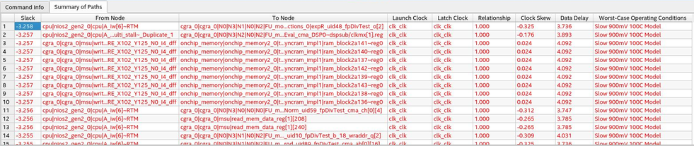

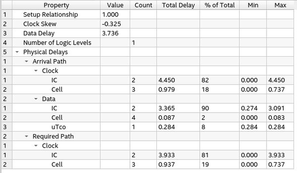

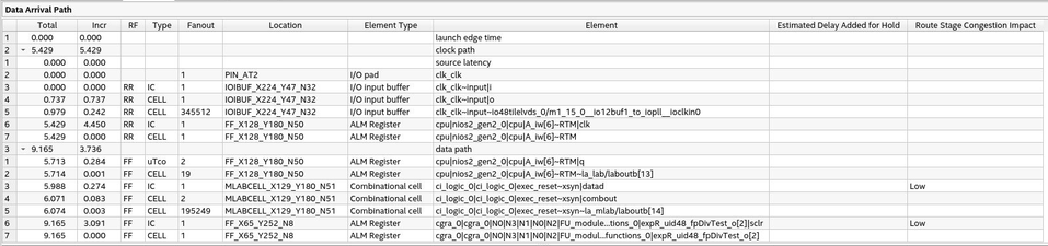

I have attached the delay for the most critical path, and also the routing utilization in Chip Planner including the most critical path.

I saw that there are only 2 logic levels which are not huge. The IC delay is likely due to the source and destination nodes being placed far away. As a start, are there a lot of fanouts from the source nodes or the combination logic? Or could there be some sort of nodes beyond this path that is pulling them in opposite direction (if you know what I mean)

Honestly, I am not sure how to find the answer to your questions. That's why I asked for some useful resources to learn about it. But anyway, I will be glad if you explain to me what is the problem based on the screenshots I attached to this message.Please let me know if there is anything else to consider.
