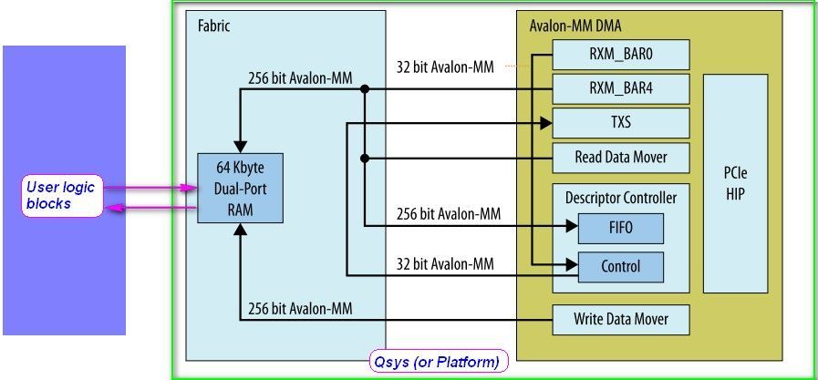

I'm studying Avalon-MM DMA PCIe referent design. Our target device is 10cx220yf780e5g. I can find the ref-design from Intel website and correspoinding an doc, an690.
But the ref-design is just for reference. avmm all implemented inside Qsys, so i need to combine with my own logic, as following image.
For me, above green square frame is as black box. User how to realize the communication channel between their own logic and that on-chip memeory inside Qsys?

- MinzhiWang
Hi Wincent,
Thanks for you reply.
In our application, the data are stored in an FIFO. So the data transfer between user logic and Qsys lay on between FIFO and the On-chip memory in Qsys.
As you said, we can't connect FIFO interface to that On-chip memory directly. We have to design one extra AVMM master for our FIFO?
Could you provide some simple tutorial papers for us to learn?
- FvM
you can start with the example project and modify the module that connects on-chip RAM as AVMM slave, e.g. xxx_integrated_onchip_memory. You'll use one port for the AVMM and one for the user logic interface. clk, address data and control signals of the user interface have to be exported as conduit which make them appear on the top level of the Qsys design.- MinzhiWang
Hi FvM,
I noticed that the on-chip RAM is connected to several master. Now one more master implemented with me will be connected to it. So how to avoid the confilict among multiple masters to access single on-chip RAM? And how user logic to know when the on-chip RAM is ready for it to access this on-chip ram?
