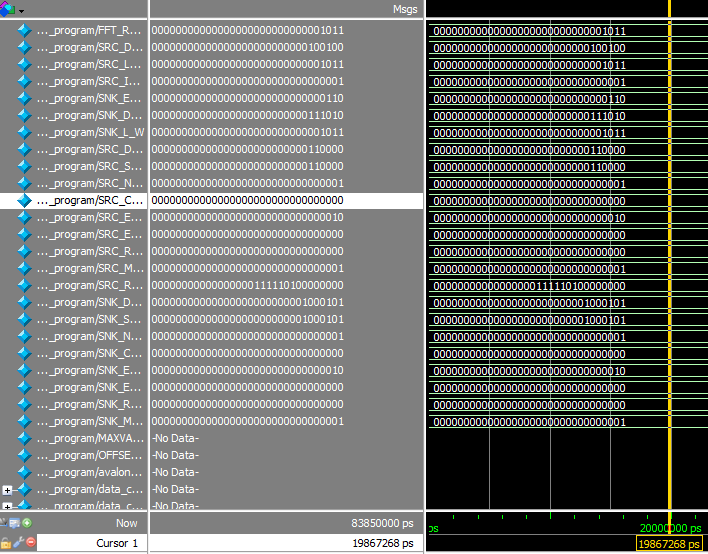

    Hi, thank you for your answer.
    I really want to generate a testbench to implement the inputs to the circuit myself because later I am going to add more blocks to the schematic.
    I get the vsim 3033 error in modelsim when I generate testbench in the ip editor and do an rtl simulation with it.
    On the other hand, I have tried what you told me but I do not know how to handle modelsim very well and this is what I have obtained by following the steps.
    Thank you for your time,

    I have emailed you a ZIP of the Q17.0 CV FFT IP generated design. You may do the following to simulate it:
    1. Unzip the files
    2. In Modelsim, change directory to the \simulation_scripts\mentor
    3. Type "source msim_setup.tcl"
    4. Type "ld"
    5. Type "do wave.do"
    6. Type "run -all"
    7. When message pops up asking if you want to finish the simulation, click "No"
    You should be able to see the example simulation waveform. Please let me know if there is any concern. Thank you.

      ICace
      Hi, thank you so much for your help.
      I did it and it works.
