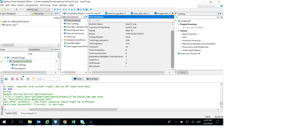

Hi, Have been able to add the qsys ADC module to the project but on final compilation the flow summary reports 0/1 ADC blocks in use even after I have selected all ports ANA1IN1 to ADC1IN8 in the qsys window.
From what i can tell the ADC module only needs a command to select which port to sample so how do i make pin assignments to confirm the ADC in use!
  • Hello there ,
    Here attached the screen shot and the modfied design file with ADC block utilization mentioned in the compliation report.
    As of understood from the design you provided , quartus is optimizing the ADC block since it is no where used in the design.
    In the modified design i instantiated the ADC input and clock as Input port which restrict the quartus to optimize the same.
    Hope helps ,
    Thank you ,
    Sree
