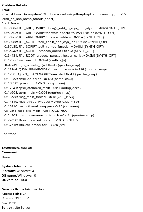

I am currently working on a project targeting a Cyclone V device using Quartus Prime versions 22.1 and 23.1. The design compiles and functions correctly with no issues. However, after adding an FFT IP core, Quartus frequently fails during synthesis with the error shown below.
The issue is reproducible in both Quartus versions. Interestingly, the compilation succeeds only intermittently (approximately once every 5–6 attempts), while most synthesis runs fail. Another observation is that if I change the Synthesis Effort setting to Fast, the design compiles successfully every time.
Has anyone encountered similar behaviour or have any suggestions on how to work around this issue?

    unfortunately, I can't upload it here publicly  due to design confidentiality . is there any other method I can use to be private  ? Thanks
  • Hi Aidin-P2D,
    Would it be possible for you to share the files via private message? I have already reached out to you through the forum inbox.
    In the meantime, could you also try compiling the design with the latest Quartus Prime Lite version and let us know whether the same issue is observed?
