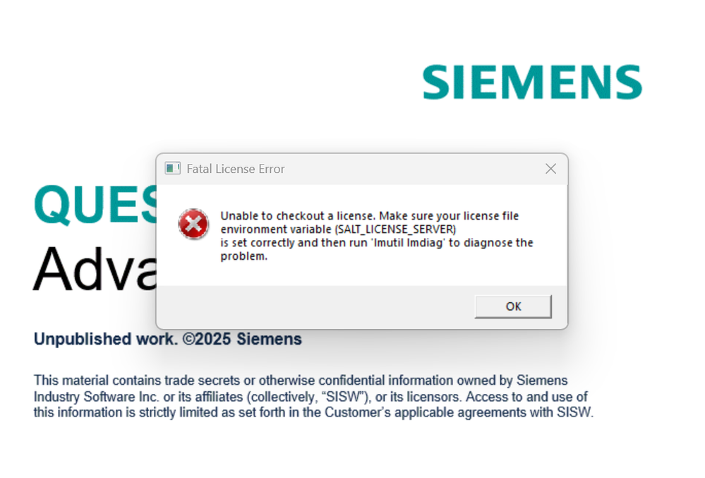

License for Questa Starter Edition will not work
I tried looking up other posts for this issue, but none of the answers people gave helped. This is the error that shows up after I downloaded the license and set SALT_LICENSE_SERVER to point to it.
I tried creating and pointing LM_LICENSE_FILE and MGLS_LICENSE_FILE too. It didn't work either. The address is correct too. I don't know what is going on
  • I finally got it to work. I pointed SALT_LICENSE_SERVER to the license file in both user variables and system variables, and that fixed the problem.

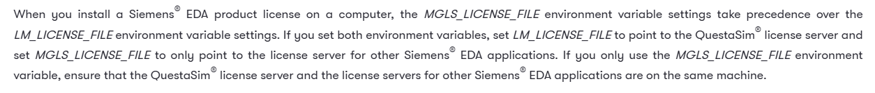

    2. Verify the MGLS_LICENSE_FILE environment variable. Since MGLS_LICENSE_FILE takes precedence, please ensure it points to the correct license path or port@hostname. It is generally recommended to define only one license source unless you are using multiple Siemens EDA products. For more information, refer to Section 4.1.2.1, "QuestaSim Software License-Specific Considerations": https://docs.altera.com/r/docs/683680/24.1/altera-high-level-synthesis-compiler-pro-edition-getting-started-guide/lm_license_file-environment-variable

      I tried setting MGLS_LICENSE_FILE to point to the Questa license file, and it just gave the following error:
      Yes, the license is correct. I tried regenerating it again, but it still doesn't work

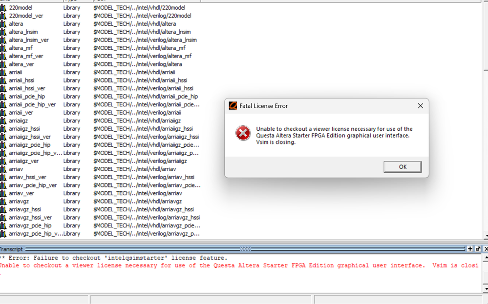

        I am having the same issue randomuser900 was having. I have Quartus Prime Pro 25.3 with its Questa (the free version) installed. I have also installed Quartus patch 25.3-0.27. The Questa license from the SSLC matches the NIC ID on my laptop. SALT_LICENSE_SERVER points to the license file. I created a system SALT_LICENSE_SERVER environmental variable also pointing the same license file, which randomuser900 reported fixed the issue. I have tried the license file on both my c: and my d: drive. Nothing has worked yet. I placed the license file in d:\license\ directory. Please help.
        When I start Quest by itself, which is way I will use it.
        When I start Questa from Quartus
