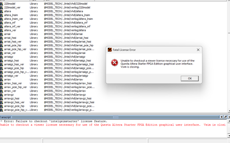

I tried setting MGLS_LICENSE_FILE to point to the Questa license file, and it just gave the following error:
Yes, the license is correct. I tried regenerating it again, but it still doesn't work
