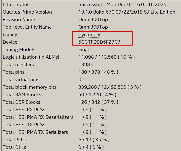

    What's your targeted device and how full is the device with this design?
    • corestar's avatar
      corestar
      Hello sstrell​ ,
      Below is the fitter report from the WIndows 7 machine. The logic usage is not very high.
