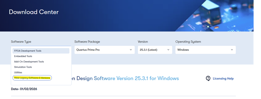

    • RichardT_altera's avatar
      RichardT_altera
      Thank you FvM​  for answering, and yes, they are all covered by a recent Quartus Prime Std. license. FYI, you can check this in the license.dat file. As long as the 'Maintenance Expiration' date is later than the release date of the Quartus Standard version, the perpetual Quartus Standard license can be used. For example, Quartus 15.1 was released in 2015, so a maintenance expiration date of 2014 or earlier will not work, but 2016 or later will work.
      You can contact our Altera Authorized Distributors for license purchase.
       https://www.altera.com/contact
      To clarify on getting the installation files, previously we needed an NDA to obtain the legacy Quartus versions, but now we have the Legacy Download Center, which allows us to download all the older Quartus versions. This really helps save a lot of time and effort.
      https://www.altera.com/downloads/fpga-development-tools/quartus-prime-standard-edition-design-software-version-16-1-b196-windows
      However, users who are new to Quartus might be confused about which versions are considered legacy and which are not.
      You can navigate there through the Download Center by selecting the " View Legacy Software & Versions"
      Richard Tan
