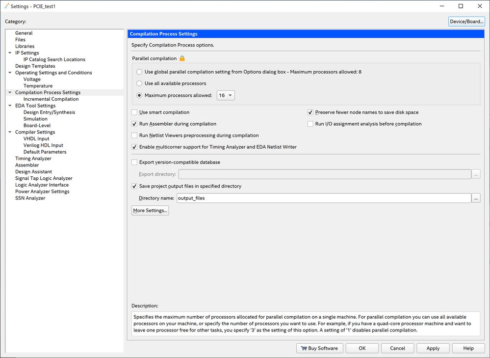

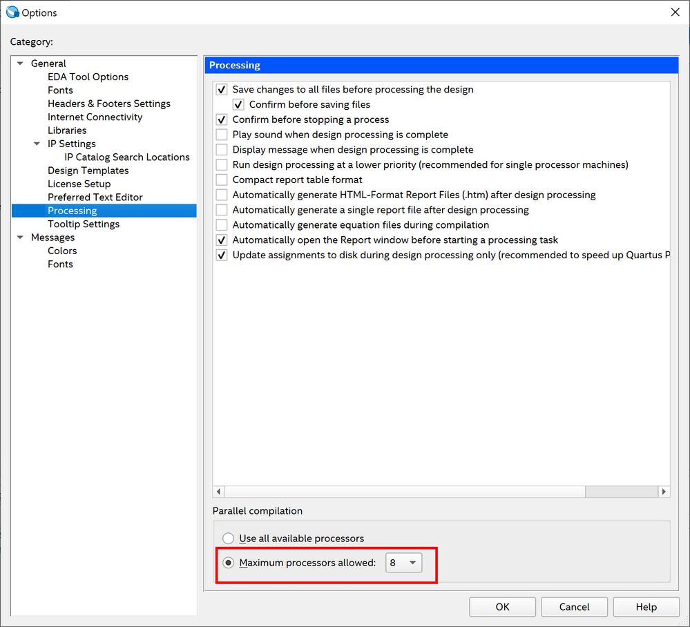

Sure, the attached is at the point where it stalls. I've also included the configurations (I've tried varying numbers for maximum allowed processors including 1, 8, 16).
