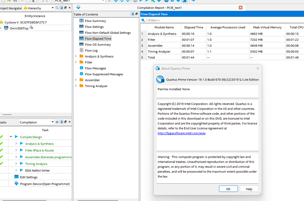

I don't have window 10. I try with window 11 without problem:
Could you try again to compile the attached design with window 10 and window 11?
