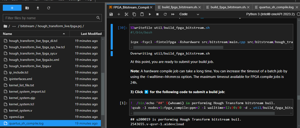

  • Hi @KatariTF,
    Thank you for posting in Intel community forum and hope all is well.
    Noted on the error, would you be able to share the URL of the example design you are trying to build with?
    Also is it correct to assume that you are trying to build in the Intel DevCloud platform based on the screenshot?
