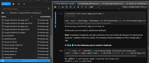

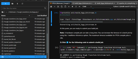

I try compile oneAPI_samples to fpga but send me a error: Error: qsys script failed! See bin/bitstream/hough_transform_live.fpga.prj/quartus_sh_compile.log for details. 4:41:50 Error: set_project_property DEVICE AGFB014R24A2E2V: The device AGFB014R24A2E2V is unknown. llvm-foreach: icpx: error: fpga compiler command failed with exit code 1 (use -v to see invocation) quartus_sh_compile.log 4:41:50 Error: set_project_property DEVICE AGFB014R24A2E2V: The device AGFB014R24A2E2V is unknown. 2024.05.17.14:41:50 Info: add_instance hough_transform_live_fpga_di_inst hough_transform_live_fpga_di 2024.05.17.14:41:50 Info: set_instance_property hough_transform_live_fpga_di_inst AUTO_EXPORT true 2024.05.17.14:41:50 Info: save_system top_hough_transform_live_fpga_di.ipSolved1.7KViews0likes4Comments
