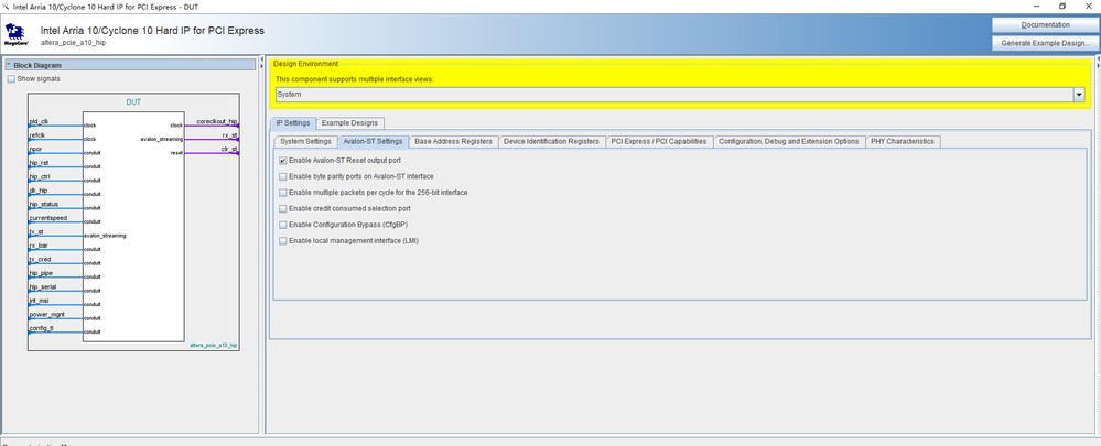

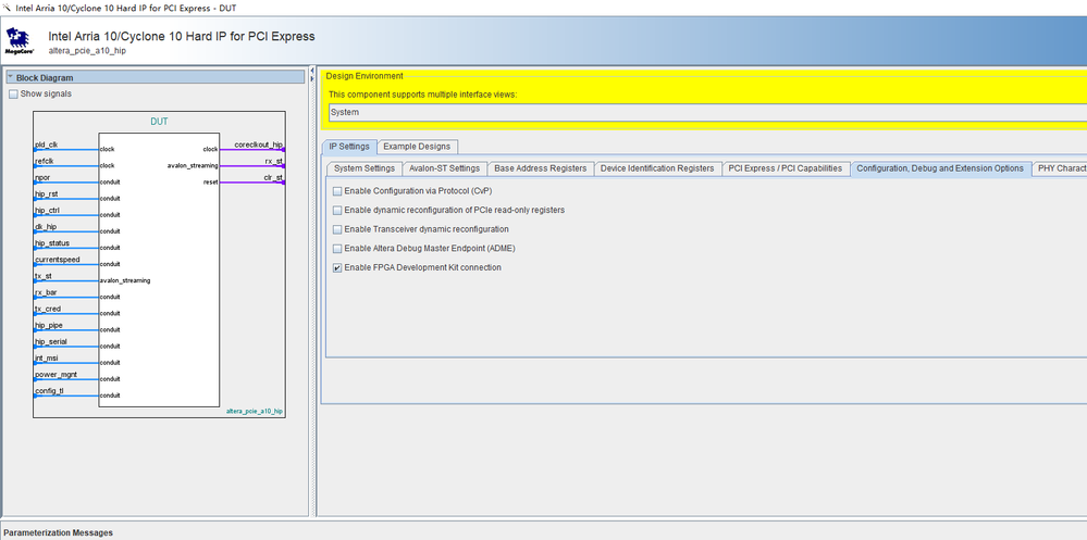

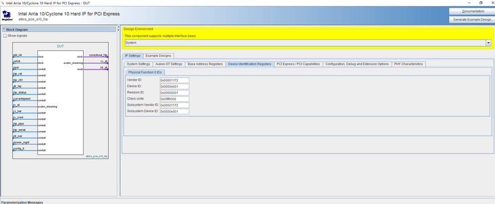

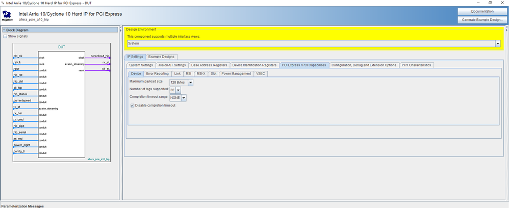

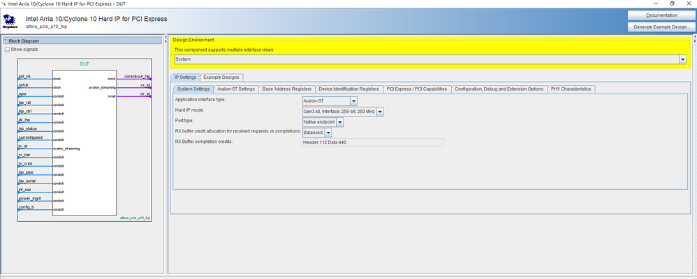

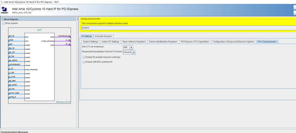

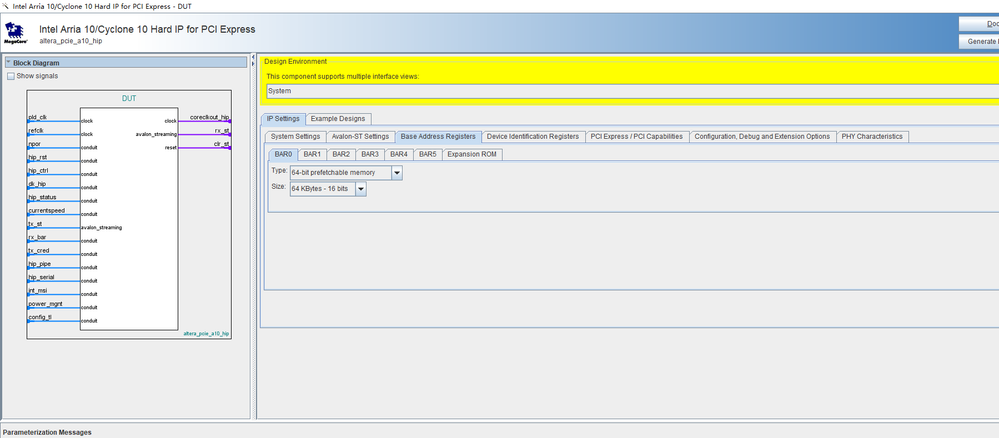

According to the user guide,i have generrated a A10 PCIe example design, the following figure is details about my configuration.
When i compile the example design, i met some errors:
I do not konw how to solve this problem, Please help...
By the way, when i configure the PCIe at Gen2 *8, the compiling of the example design succeed., but error with PCIe Gen3*8.

        LSant1
        This issue seems to be about regenerating IP files. Once IP core files are regenerated, compilation should work fine.
