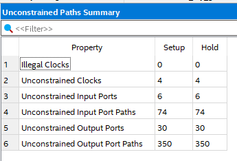

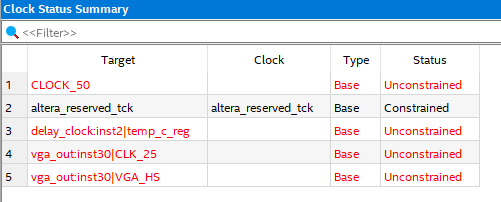

Do you check if the design is passing timing analysis?
It says "Quartus Prime Timing Analyzer was successful. 0 errors, 24 warnings".
In compilation report, Timing Analyzer/ Unconstrained Paths/Summary, and ../Clock Status Summary is in red color.
sorry if i misunderstood it and Time Analyzer, i haven't use Time Analyzer yet.
Is the pin location has been assigned correctly based on the board?
yes, all pins are assigned correctly in Pin Planner

- sstrell
Well, this is certainly correct for a bidi so your attached file is wrong: assign sram_dq = sram_we_reg? render_dq : 16'hz;
And your design is not constrained for timing. You need to create a .sdc file and constrain those clocks and the I/O. User guide is here: https://www.intel.com/content/www/us/en/docs/programmable/683068/18-1/timing-analysis-introduction.html
