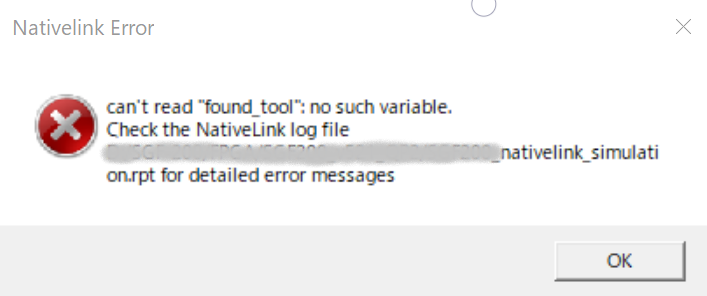

I installed Quartus Prime Lite Edition(23.1) and did synthesis my old design ( By Qualtus II).
Synthesis is OK, but I can't start RTL simulation (Questa Intel FPGA) because of following Error.
Message says .rpt file has detail, but .rpt file is empty.

It seem like the quartus complain that they can't find the simulation tool.

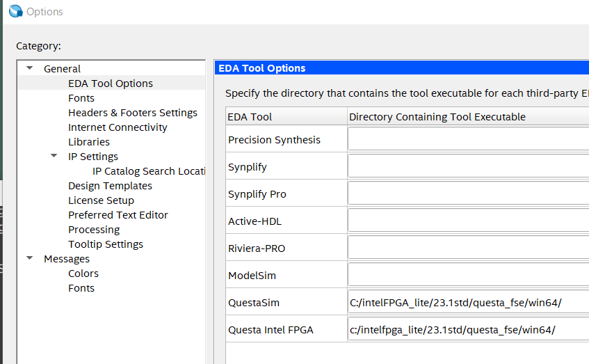

Have you specify the location of the tool executable for questa? Tools > Option> EDA Tool Options.
I found "vsim.exe" in c:/intelfpga_lite/23.1std/questa_fse/win64/ , so I think settings are correct.

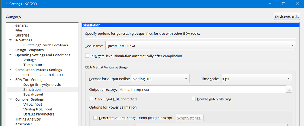

(following phots are settings)If you know another setting, I'm very happy to know that.
I think this error comes from tcl script execution...
