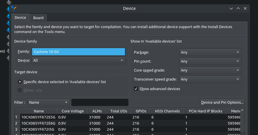

Cannot Select Device Family Other than Cyclone X
I recently installed Intel Quartus Prime Pro 24.2 on RHEL8 with all of the supported device families selected during installation. When I try to create a new project, I cannot select a family other than Cyclone 10 GX. Additionally, when I try to select a board with another processor (Agilex 7 for example), I get an error and then Quartus crashes. I have reinstalled the software from scratch but that did not seem to fix the issue. Is there something I am doing wrong with regards to file permissions and / or installation? Is there something I can check to see what's wrong? Screenshot below.
Abraham

    Sounds like missing Quartus Pro license. Only Cyclone 10 GX can be used without license.

      Even without a license, you'd still be able to select a different installed device family.
      What other families did you install? If it's Agilex, there is a common file for all Agilex devices as well as one for a specific family (Agilex 3, 5, 7, 9). You have to install the common file along with the family specific one.

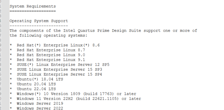

    Could you try to install the Quartus in supported OS? It seems that Quartus 24.2 is not supported in RHEL 8.
    You can download and check the readme.txt in the Table 2.
    https://www.intel.com/content/www/us/en/support/programmable/support-resources/design-software/os-support.html#editorialTableBlade-6
    Additionally, please check that your machine system meet the minimum Hardware and Software Requirements.
    https://www.intel.com/content/www/us/en/docs/programmable/683472/current/system-requirements-and-prerequisite.html
