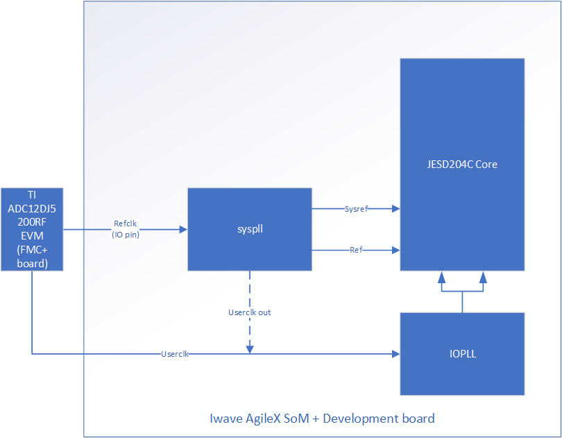

  • So turns out if I use an external clock for my IOPLL the problem is resolved.
    Dotted line is the configuration in the project above resulting in the error, solid line for userclk (reference to IOPLL) from another FPGA pin works fine:
