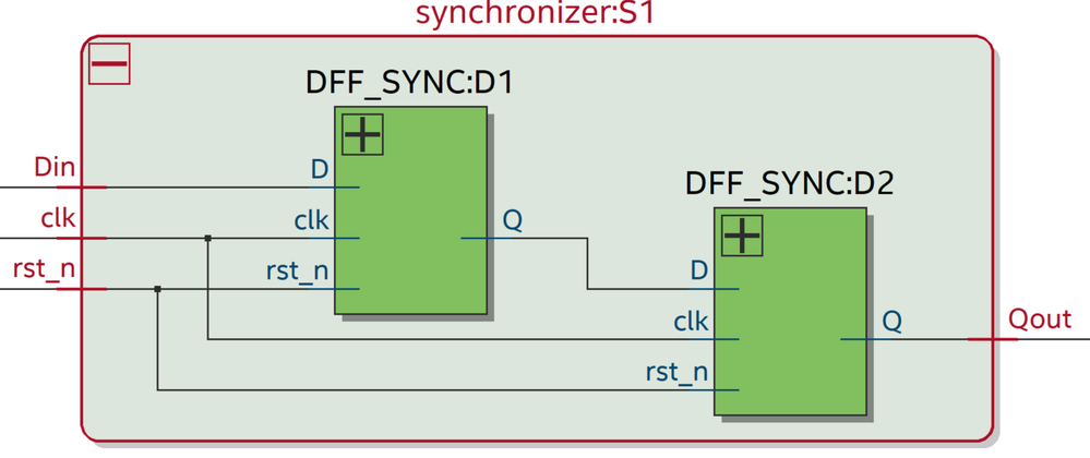

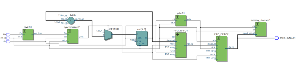

Below is my RTL picture:
More information for the 2DFF synchronizer :

The Node: synchronizer:S1|DFF_SYNC:D2|Q I think it shouldn't be a clock signal,
it's just a signal that I want to synchronize to the clk domain.

You have the output of the synchronizer connected to the rdclk and wrclk inputs of 2 FIFOs. Is that intentional? If so, that is considered a clock and needs a create_generated_clock constraint.
- PonPon
Yes, I want the output of the synchronizer to be rdclk and wrclk of 2 FIFOs.
If I want to do this, how to correctly constraint this signal with create_generate_clock command?
- sstrell
It depends on out_freq. You have to specify the properties of this newly generated clock.
create_generated_clock -name <custom name> -source <input to synchronizer> <output of synchronizer> <output clock relationship to source>
- PonPon
I’m not really sure about the properties of this clock, can you tell me more information?
out_freq will go into the 2DFF synchronizer, and then the synchronizer output this clock, I only know about this.- sstrell
What is the frequency of out_freq? You have it coming from an outside signal Fin then go though something you've named div2 so there's no way for me to know what the properties of this signal are.
- lishilton
the same
- ShengN_altera
May I know does your problem resolved with create_generated_clocks?
If the syncrhonizer Din and Qout clock is the same then you probably not need the clock relationship, constraint like below will do:
