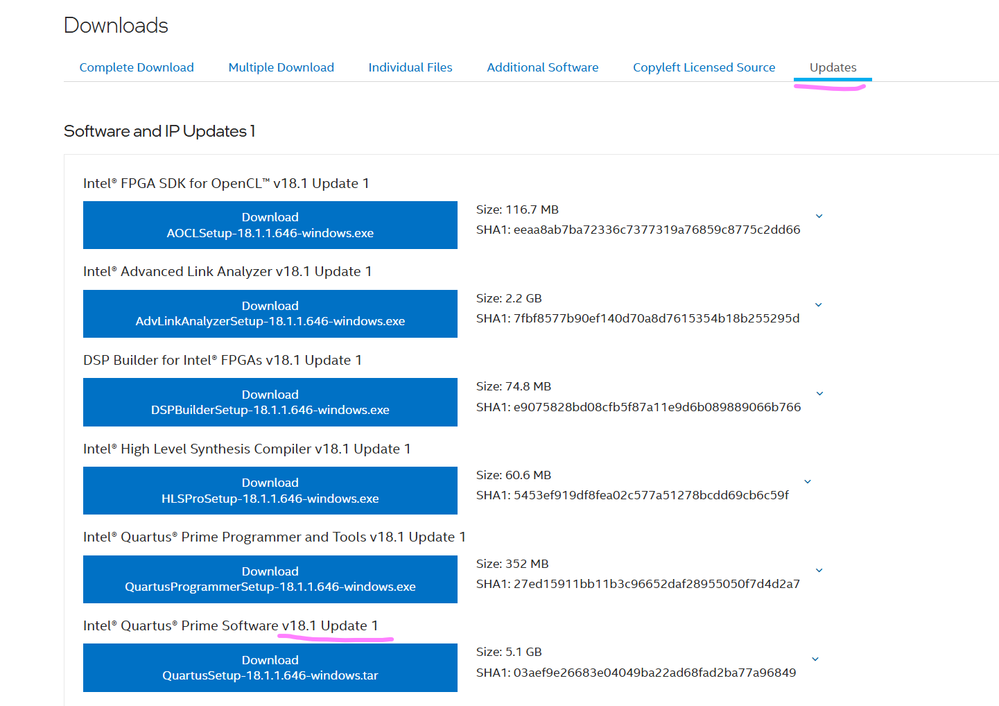

Cyclone® V FPGA – Generic Serial Flash Interface and Nios® II Processor Booting Design Example
If you are OK to upgrade to 18.1std.1 version, you may go to Intel® Quartus® Prime Standard Edition Design Software Version 18.1 for Windows and download update 1 setup package shown as below.
Hope this is helpful.

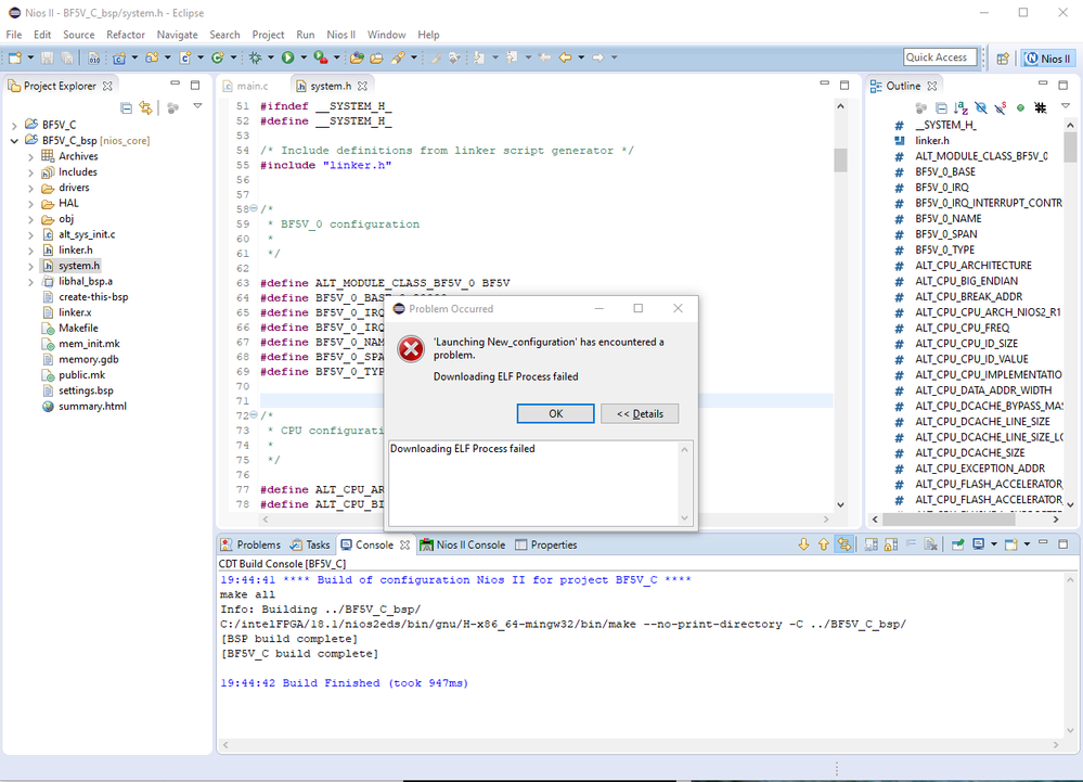

I have already found a good IP(Serial Flash Controller Intel FPGA IP) that supports EPCS64 flash.
I have already tried this IP. I can program jic file via Quartus--> Tools--> Programmer.
but I can't program elf file via Eclipse--> NIOS II --> Flash Programmer.
Is there any way to program elf file or binary of C code if I use Serial Flash Controller Intel FPGA IP?

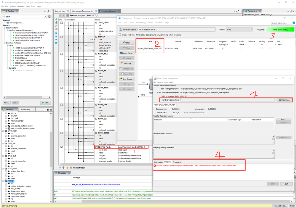

- ZhiqiangLiang
Thank you!
I have already read the pdf you mentioned. The picture I pasted is the result when I follow the pdf.

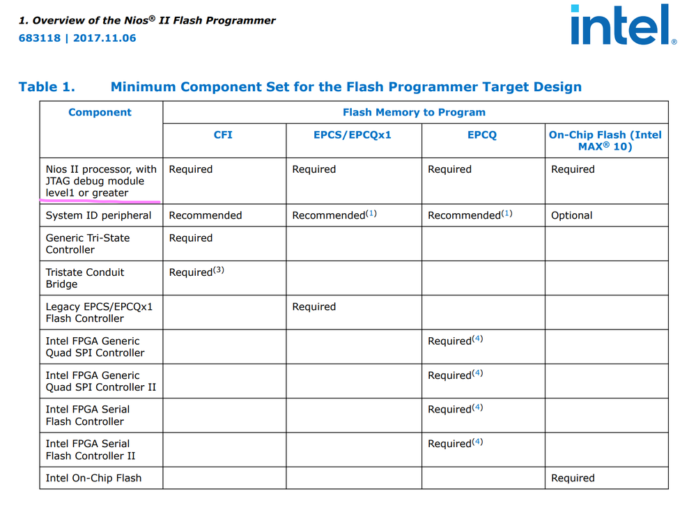

- Archer_Altera
Hi Zhiqiang,

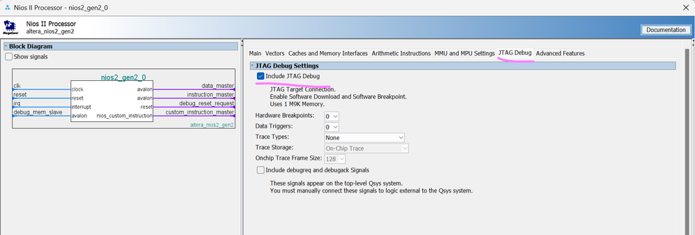

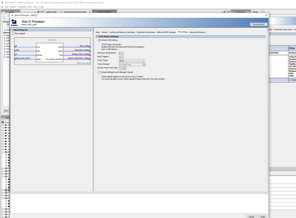

Below table shows the minimum component set required. Have you enabled JTAG debug module level1 or greater?
- ZhiqiangLiang
- Archer_Altera
Hi Zhiqiang,
It is set in Nios II processor IP shown as below.
- ZhiqiangLiang
Thank you!
By default, Platform Designer set JTAG Debug mode. I have never set or changed it.

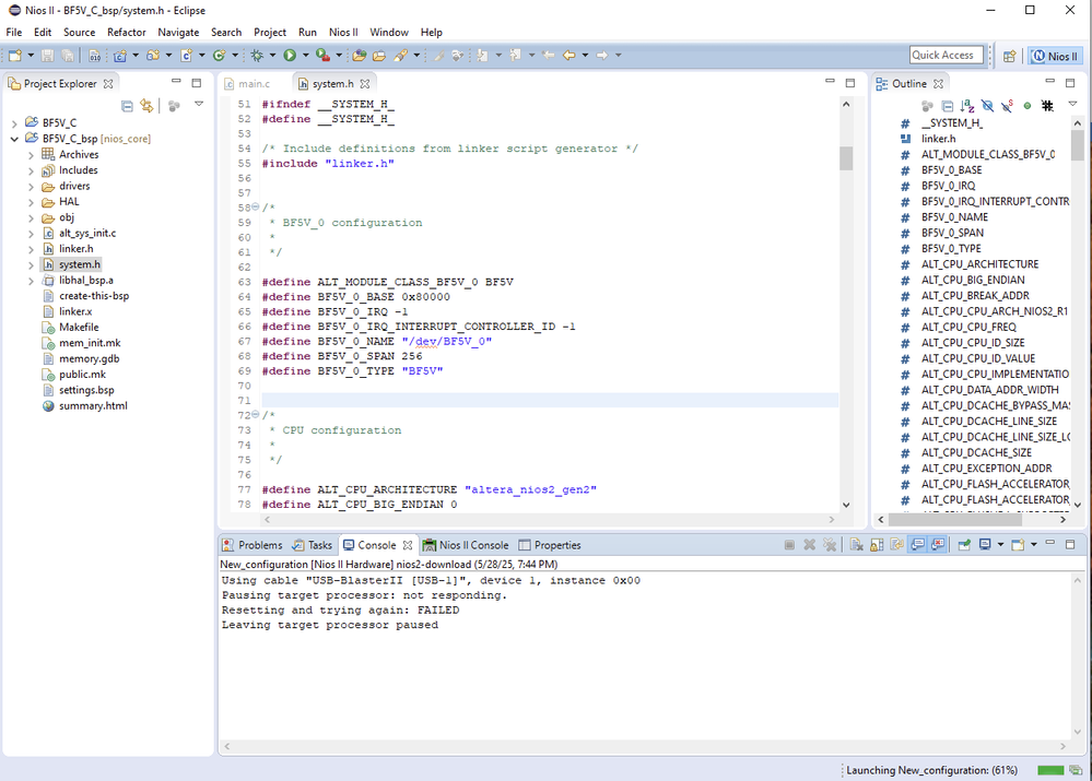

Let's go back to my question:
I followed the settings in your link pasted above, but I am still facing the issue that NIOS II Flash Programmer can't find the device.
Could you please tell me how to solve that issue?

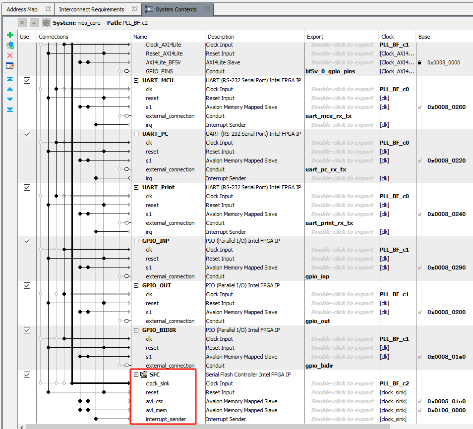

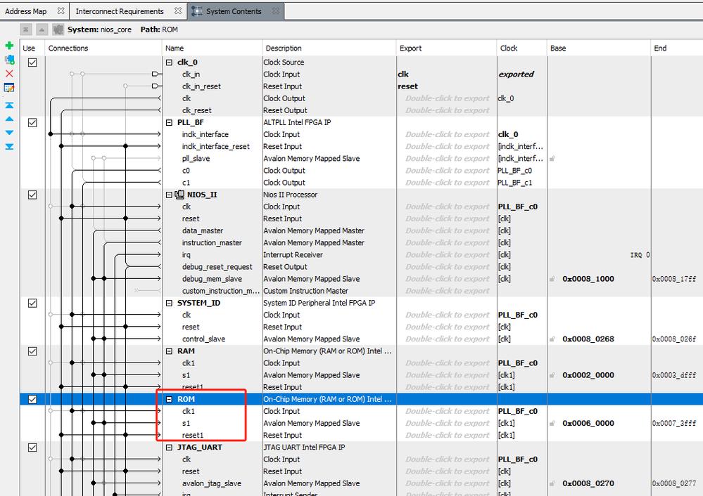

There are 3 steps to generate elf image hex file:sof2flash --input= TFT_SRAM.sof --output=hwimage.flash --epcs –verbose
elf2flash --input=tft_touch.elf --output=swimage.flash --epcs --after=hwimage.flash –verbose

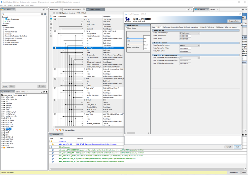

nios2-elf-objcopy --input-target srec --output-target ihex swimage.flash swimage.hexmy questions are:1) My flash is EPCS64, in the upper commends, should I use --epce64 or --epcs?2) If I follow your link to program jic file, I don't need to generate ROM in Platform Designer, right? I should remove the ROM in the design in the following picture, right?After I remove ROM in my design, I add "Serial Flash Controller Intel FPGA IP".I set NIOS II reset vector memory in the following picture."Serial Flash Controller Intel FPGA IP " is connected to NIOS II shown in the following picture.3) when I run sof2flash command, I encountered the issue:May 28, 2025 2:53:38 PM - (FINE) sof2flash: Starting
foo:10A10CL120YF484I7GMay 28, 2025 2:53:38 PM - (SEVERE) sof2flash: Unrecognized device family in SOF.
The sof2flash utility takes an FPGA configuration file in SOF format and
translates it to a FLASH file that can be programmed into the flash
memory connected to an Altera FPGA.The device model I am using is: Cyclone 10 LP 10CL120YF484.4) I follow the steps blow :quartus_cpf -c --device=EPCS64 -o auto_create_rpd=on -o rpd_little_endian=on NIOS_BF5V.sof NIOS_ONLY_sof.pof

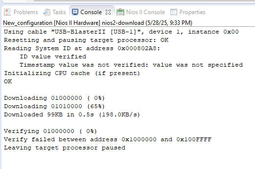

After the upper programming, I don't know whether the SW(C code ) could be run in NIOS(FPGA) as I cannot debug it from Eclipse. The reason is pasted in my upper post.
Please see the third picture in my upper post. Eclipse report: Verify failed between address 0x1000000 and 0x100FFFF.
I doubt there is a mistake in my operations. when I generate jic file, there is a map file generated. please the the map file below pasted.
My doubt is:
swimage start address in flash is: 0x00367F06, why did Eclipse very the address 0x1000000 and 0x100FFFF?
where and how can I tell Eclipse the sw image start address?
