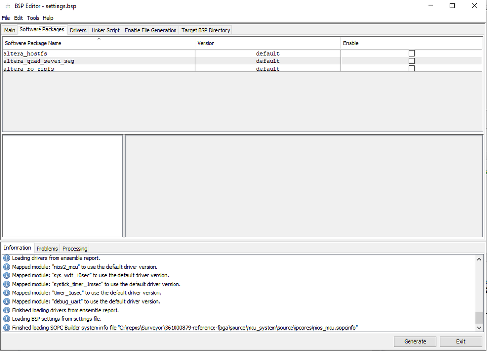

    • meenalkb's avatar
      meenalkb
      As you can see, I don't see the altera_safeclib option under Software Packages. What now?
  • hareesh's avatar
    hareesh
    can you share screen shot of that ?
    • meenalkb's avatar
      meenalkb
      I did include a screenshot - perhaps you can't see it. I've attached one now.

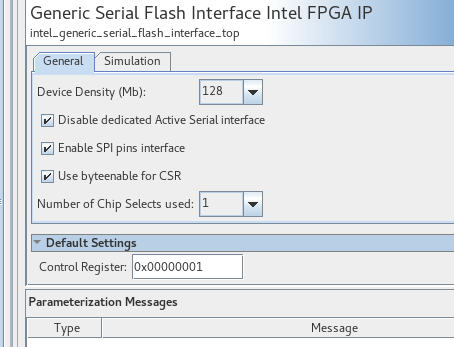

      • hareesh's avatar
        hareesh
        gsfi ip need enable setting then regenerate sopcinfo then should see altera_safeclib
  • meenalkb's avatar
    meenalkb
    Hmm tried that.
    That makes no difference whatsoever.
