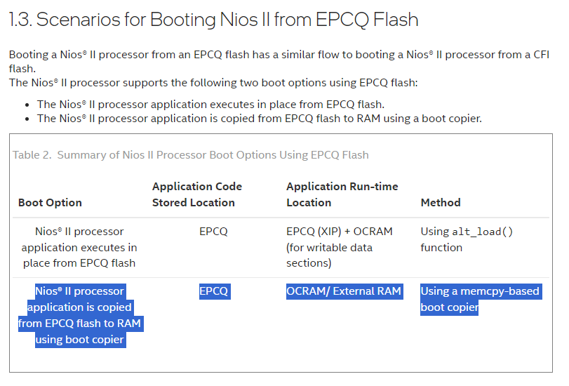

    I am adding the reference design for ddr3 with nios . In that, we are trying to flash the EPCQ device and it is not programming properly.
    the above highlighted boot option we are trying to achieve.

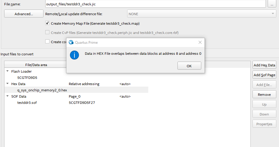

        i have tried to generate .jic file also but i am getting error as address overlap
        can you please give solution for this.
  • Hi,
    You are getting error related to this same thread.
    https://community.intel.com/t5/Intel-Quartus-Prime-Software/Error-to-add-HEX-file-in-Convert-Program-File-tool/td-p/189986
    https://www.intel.com/content/www/us/en/support/programmable/articles/000086201.html
    You can try below step to solve it.
    Add your Hex file in project directory (Should be visible in files window)
    1. Go to file ->Memory Files->Hex Decimal(Intel Format) File->select ->Ok
    2.Number of words and word size Tab will open ->Let it be default values dont change any values.
    3.New hex file will be opened in your
    4. go to tools->options->Memory Editor->Uncheck the option Read or write Hexadecimal Files (.hex) using byte addressing (Intel format)->Ok
    5.Open you hex file one after the other by double clicking it (from project navigator->files)->hex file word size tab will be opened ->click ok
    6.Again go to tools->options->Memory Editor->check the option Read or write Hexadecimal Files (.hex) using byte addressing (Intel format)->Ok
    7. do same for another hex file from step -3.
    Now generate the .pof file.
    Thank you.
    Fathulnaim
