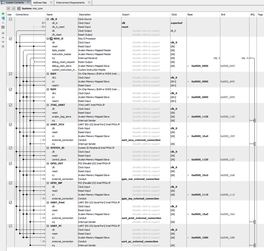

in my Cyclone 10 FPGA, I instance NIOS II, RAM(120KB), ROM(80KB), UART, JTAG, but no EPCS Flash controller as which is not supported by Cyclone 10 family.

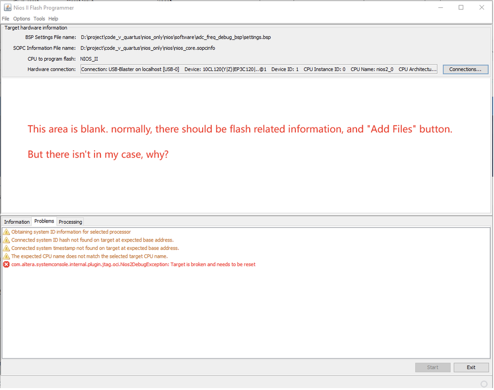

Eclipse-->NIOS II -->Flash Programmer, I can't program elf as well, because:
1) The tools report error: Target is broken and needs to be reset, however, Quartus-->Tools-->Programmer is able connect and burn jic file to flash.
2) I don't know where the elf is burned through Flash Programmer?

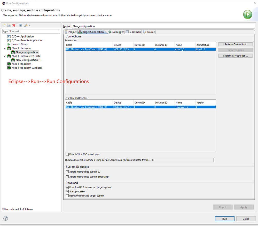

Eclipse-->Run-->Run Configuration, by this tool, I can

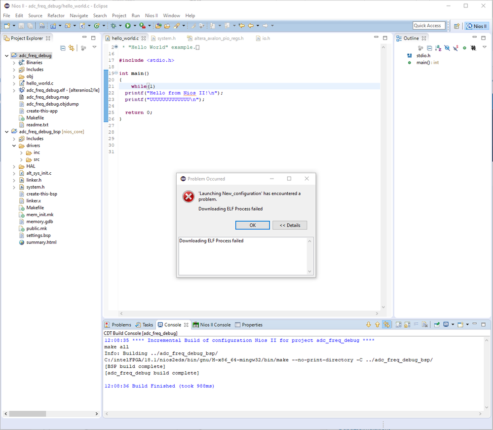

    I tried many times, but I cannot program flash. Finally, I found out one way:
    1) add ROM, and Contents: enable and point to rom_init.hex which is compiled in Eclipse-->Project right mouse key --> Make Targets-->Build-->mem_init_generate
    2) re-compile project in Quartus.
    3) Quartus-->File --> Convert Programming Files-->convert sof file to jic
    4) Quartus -->Tools-->Programmer--> program the jic file
    5) Eclipse --> Run, the C code could be run to NIOS II RAM.

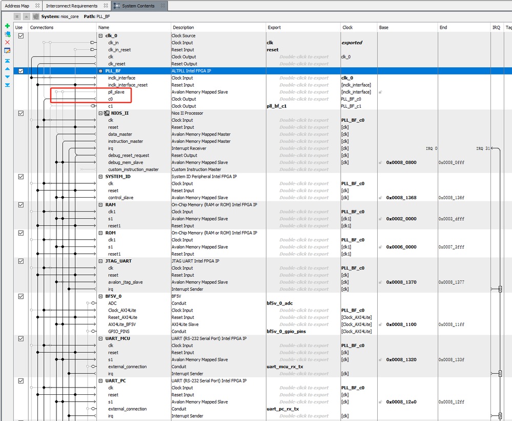

    2) what is pll_slave in the following picture? should I connect it or not?

      Answer for 2
      In Platform Designer the pll_slave port on the ALTPLL IP is simply its Avalon‑MM “control/status register” interface. It lets Nios II read and write the PLL’s configuration and status registers at run‑time (e.g. to tweak phase, reconfigure frequencies, or poll the “locked” bit).
      When you do not need to hook up pll_slave
      • Static, compile‑time configuration: If you’re happy with the PLL settings you picked in the megafunction GUI (or tcl script) and you never intend to change them in software, you can leave pll_slave unconnected. The FPGA will still configure the PLL exactly as you specified before you even boot Nios II.
      • No driver/library support: If you don’t plan on writing C code to poke the PLL’s registers (or you’re not going to use Altera’s ALTPLL_RECONFIG API), it’s dead weight.
      When you should connect pll_slave
      Dynamic reconfiguration: If you want your Nios II code to call into Altera’s PLL‑reconfig library (for example, the altpll_reconfig BSP component) to adjust the output frequency or phase on the fly, you must wire pll_slave up to your system bus:
      1. In Platform Designer, connect pll_slave to your Nios II’s data_master (and/or to the same interconnect as your other CSR ports).
      2. Export its base address (double‑click its port on the “Export” column) so that system.h sees something like #define ALTPLL_SLAVE_BASE 0x...?.
      3. Then in C you can use the reconfig API e.g.
      #include "altera_pll_reconfig.h"
      ALT_PLL_RECONFIG_INSTANCE (my_pll, ALTPLL_SLAVE);
      altpll_init(&my_pll);
      // … later …
      altpll_reconfig(&my_pll, ALTPLL_RECONFIG_CMD_MHZ(100));
      Status monitoring: Even if you never change frequencies, you might want to poll the PLL’s “locked” status bit to gate your system reset. That also requires the slave port.
      Bottom line:
      • No—you can safely leave pll_slave unconnected if you only need a fixed PLL setting, and you aren’t going to touch it from software.
      • Yes—wire it up to your Nios II’s Avalon-MM bus (and export its CSR address) if you plan to use the Altera PLL reconfiguration/status API in your C code.
      In the ALTPLL IP you see two “c” ports—c0 and c1—these are simply the PLL’s clock outputs. When you open the megafunction GUI you told it to generate up to N outputs (each can be a different frequency or phase), and they get named c0, c1, c2, … in the Qsys schematic.
      • c0 is your first PLL output clock (often used as your main system clock)
      • c1 is your second PLL output clock (maybe configured to a different frequency or phase)
      What to do with them:
      If you only need one clock domain
      • Use c0 to drive all of your logic (for example connect c0 to the Nios II clk input).
      • You can leave c1 un‑connected in Qsys—nothing bad happens.
      If you need multiple clock domains
      • Wire c0 into the clk input of the modules you want at frequency/phase #0.
      • Wire c1 into any other modules that need the second frequency/phase.

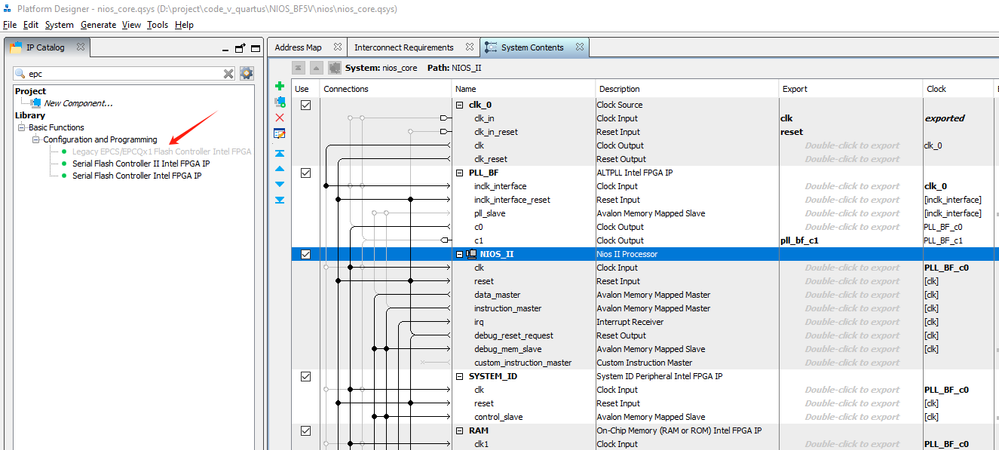

    I perhaps know the reason why it is blank in the following picture.
    I didn't add a flash controller in Platform Designer.
    The reason why I cannot add flash controller in Platform Designer is that the flash I am using (M25P64 which is EPCS64) is not supported by Cyclone 10 family.
