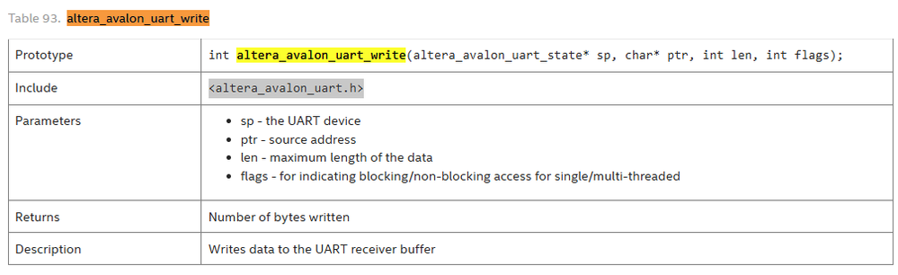

Thank you for your reply!
one more question is:
which header file I should include in C code to use the api altera_avalon_uart_write?
- TienfongC_Altera1 year ago
You should include <altera_avalon_uart.h> in C code.
https://www.intel.com/content/www/us/en/docs/programmable/683130/24-3/uart-api-41542.html
