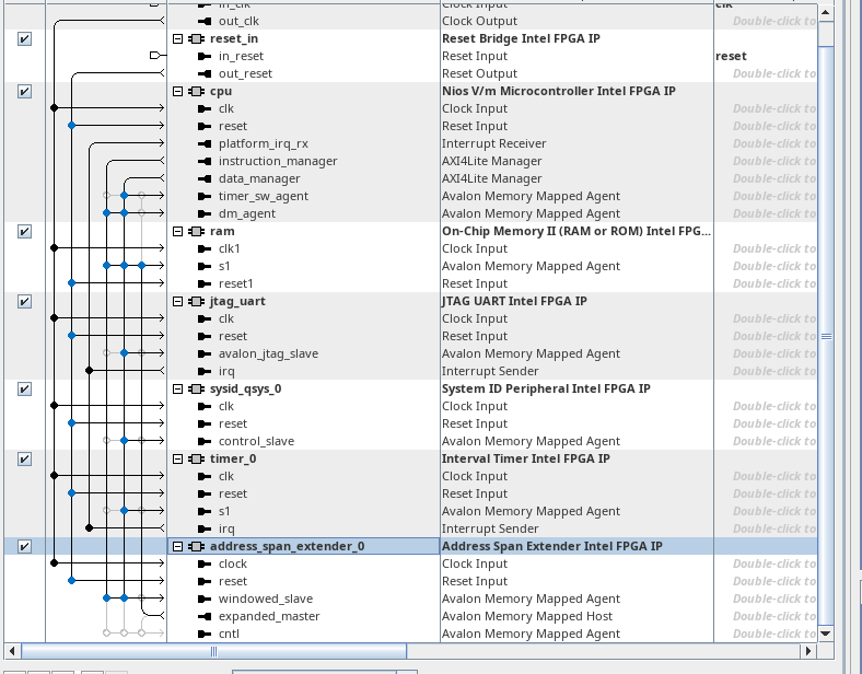

- fa_fpga_enthusiast
Thanks for the reply.
The main problem is that the Address Span Extender is not visible as the processor's memory.
We found a workaround to make the Address Span Extender visible as memory for the processor by following the procedure described in the thread below:
Link to Intel Community Thread Although the solution was provided almost 10 years ago, it surprisingly remains unresolved in the latest Quartus version. We successfully tested a similar approach on an Agilex-7 FPGA, though that was some time ago.
Also, in Quartus 24.1, in the Nios V Processor parameter editor, we could not find the Exception Agent section under "Vectors". Do we need to follow a special process to enable it? We are using "Nios V/m Microcontroller Intel FPGA IP".

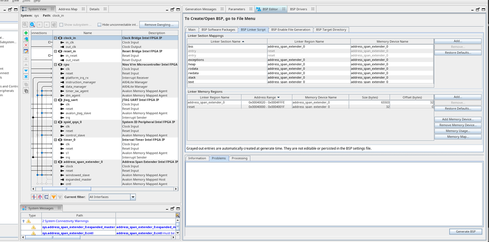

Thank you for your response.
You might not be seeing the warning because the "altera_address_span_extender_hw.tcl" file was not modified as we previously explained. Without this modification (or a similar one), how can the Address Span Extender be recognized as visible memory for the processor when generating the BSP?
Even if we attempt to define the memory regions manually, we are unable to select the Address Span Extender when pressing the "Add" button—unless the mentioned TCL file is already modified.
Additionally, manually defining memory regions every time we generate the BSP is not an ideal solution. We expect the tool to handle this automatically.
Also, we tried "Assign Base Address", "Assign Interrupt Number," and "Sync System Infos", but the warning is still there.
A screenshot is attached showing where the warning appears.
We are using Quartus 24.3.1.
Looking forward to your thoughts.
Best regards.

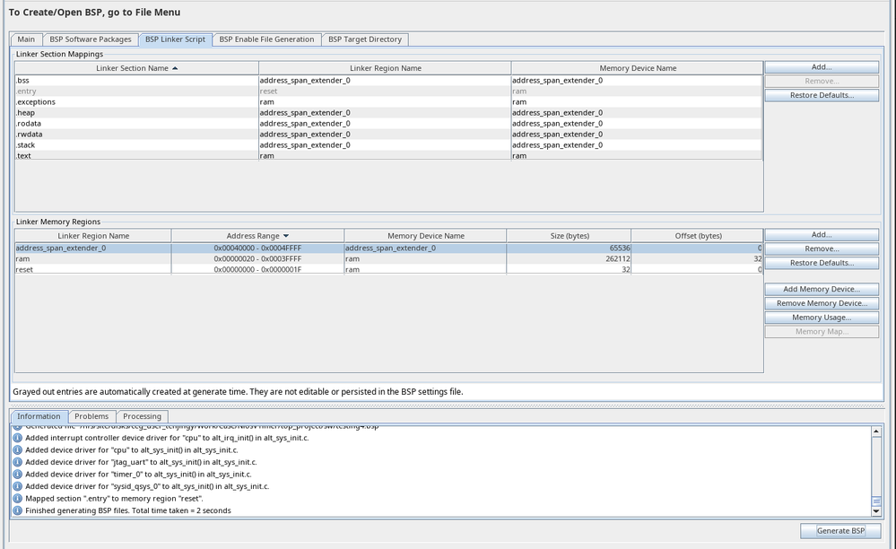

- tehjingy_Altera
Hi
I think it could be the naming when you add in the memory device.
It should be the same device name as the IP name in the PD.
Please find the screenshot below:
Jingyang, Teh
We’ve noticed a key difference in how the memory device name appears when using the Address Span Extender IP core.
In our case, the memory device name includes the suffix _windowed_slave, like so:
address_span_extender_0_windowed_slaveThis seems to be the main difference between our system and yours.
The critical warning appears in the "Problems" tab when we press the "Generate BSP" button.
Didn't you encounter the same issue?
Also, could you confirm if you're using Quartus version 24.3.1?Typically, the Address Span Extender is placed between the processor and a larger memory that exceeds the processor's addressable range. However, in your system, we noticed the processor is connected directly to the memory and also via the Address Span Extender.
We tried different connections and topologies and always received the warning.
In summary, here are the key differences we observed:
- The memory device name in our system is address_span_extender_0_windowed_slave, while in yours, it appears without the _windowed_slave suffix. Could you please let us know why we are seeing this difference?
- When we press the "Generate BSP" button, we receive the warning that we already mentioned in the "Problems" tab.
Best regards.
You're not seeing the "_windowed_slave" suffix because the "cntl" port of the Address Span Extender is not connected to the "data_manager" port of the processor. This connection is typically required to allow the processor to modify the Address Span Extender's settings if needed.
Also, you're not seeing a warning in the "Problems" tab because the altera_address_span_extender_hw.tcl file located at:
<install_dir>/ip/altera/merlin/altera_address_span_extender
was not modified as described in the following Intel forum post:
https://community.intel.com/t5/Programmable-Devices/NIOSII-using-the-FPGA-to-HPS-SDRAM-Bridge-via-Address-Span/td-p/150256As previously mentioned, we need to remove the # character from the following lines to enable automatic detection of the memory device:
#set_interface_assignment windowed_slave embeddedsw.configuration.isMemoryDevice 1 #set_interface_assignment windowed_slave embeddedsw.configuration.affectsTransactionsOnMasters "expanded_master"
We have now reinserted the # character before the second line, and as a result, the warning no longer appears.
