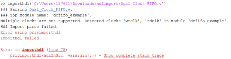

      I have implemented some Verilog examples and imported them with the HDL Import function and they worked.
      On the other hand, I have implemented a Verilog example of a dual clock FIFO memory and tried to import it, but it gives me error:
      Is there anyway to use two clocks in general in DSP? DSP builder does not provide any provision for clock to any of its components. It takes the default clock which one sets in the control block.

    Yes, that will work as a system clock (Maximum Clock). the write clock and read clock will be your normal 1-bit signals and the inputs to it is like clocks, you want to give.
    You can share your example design. I will take a look and check how it can be done as per your requirements.
