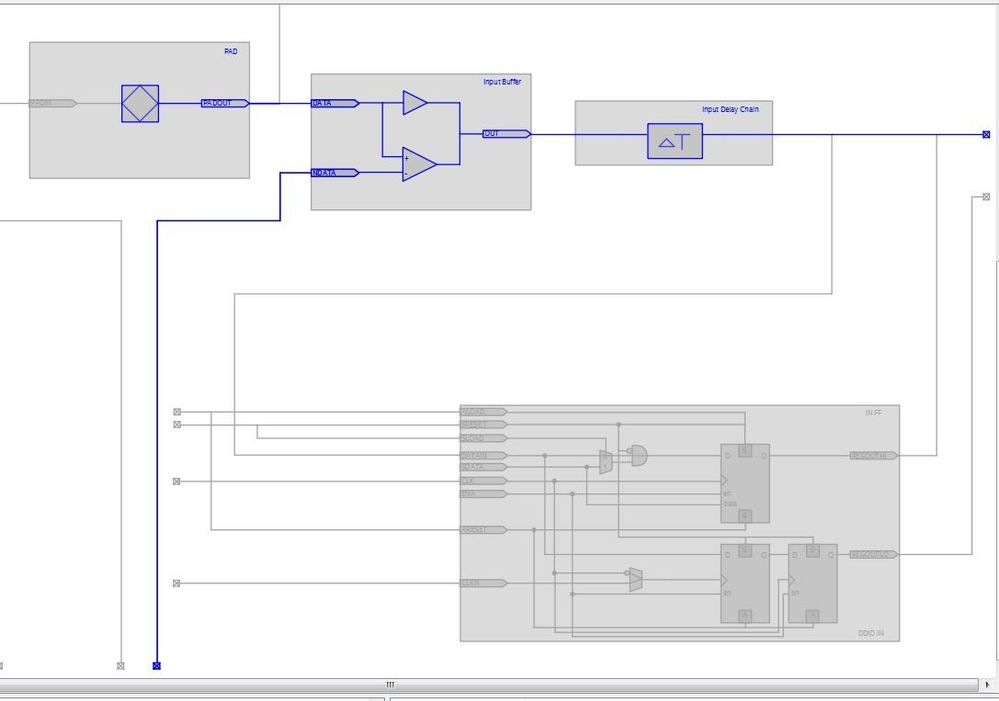

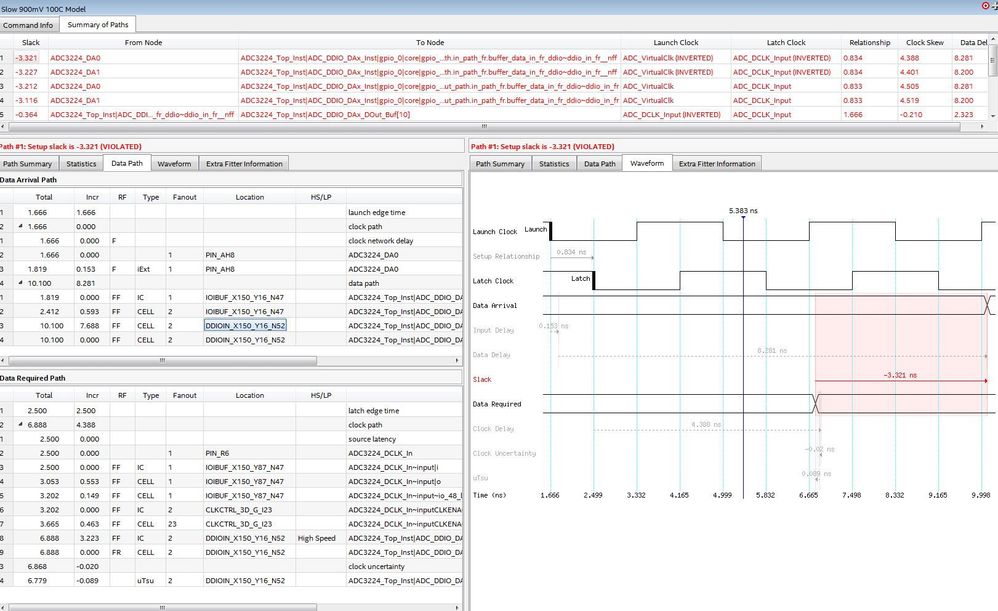

After all these setting and timing constraint, I got setup time violation shown as figure “step_violate_DA0”. What makes me confused is in the input data path, why the “DDIOIN_X150_Y16_N52” internal connection spent so much time (7.688ns) and when I click to view this path in “Resource Property Viewer”, it surprises me that looks like the fitter didn’t locate this path into DDIO_In block (right-down region of figure “DA0_Input_Path”). It happens on every device and Quartus version I’ve tried above. What makes me confused is even though there’s time violation, but in SignalTapII, the ADC data are correct.
In my understanding, SDC timing constraint will instruct the fitter to place logic blocks and adding routing delay as much as it could to match setup and hold time. The case I met is more like the fitter got wrong instruction and trying to adding extra data path delay in internal connection.
Furthermore, if data path delay in “DDIOIN_X150_Y16_N52” can’t be avoid, according to TimeQuest’s waveform, should I add multi-cycle path constraint to specify the offset of latch edge?

    I checked in the Timing Analyzer. The register is located within the I/O. According to the user guide https://www.intel.com/content/dam/www/programmable/us/en/pdfs/literature/ug/ug_altera_gpio.pdf, you may set the delay elements manually in the Intel Quartus Prime settings file (.qsf).
    Input Delay Element
    set_intance_assignment –to <PIN> -name INPUT_DELAY_CHAIN <0..63>
    Output Delay Element set_intance_assignment –to <PIN> -name OUTPUT_DELAY_CHAIN <0..15>
    Output Enable Delay Element
    set_intance_assignment –to <PIN> -name OE_DELAY_CHAIN <0..15>
    You may try to set the max and min value and see if it helps the timing.

    According to https://www.intel.com/content/dam/www/programmable/us/en/pdfs/literature/an/an433.pdf (Page 40), you have to create the virtual clock with the same period and phase shift as the real clock in the source device, which means that the following two constraints need to have same phase shift.
    create_clock -name {ADC_DCLK_Input} -period 3.333 -waveform { 0.833 2.5 } [get_ports {ADC3224_DCLK_In}]
    create_clock -name {ADC_VirtualClk} -period 3.333

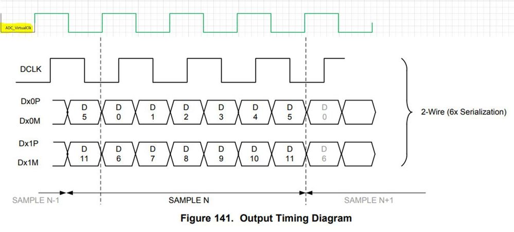

      Thanks for reply. In my understanding and according to ADC3224 data sheet(page 45), data are clocked out 90 degrees prior the rising and falling edge of DCLK.
      Waveform below is the output timing diagram of ADC3224 in x6 mode, and the green signal is the virtual clock I added to described the clock of ADC output registers.
      In my application, Frame Clock(FCLK) runs at 100MHz and therefore both virtual and actual output clock of ADC are set as 300MHz in SDC.
      Therefore I think it's more like the definition "Case 2: The FPGA is the receiver and does not phase-shift the clock" in Ryan Scoviller's writing, "Source-Synchronous Timing with TimeQuest".
      That's why in my SDC I described a 90 degrees(0.833 ns) phase shift on ADC_DCLK_Input, instead of making ADC_DCLK_Input and ADC_VirtualClk having the same phase shift.
