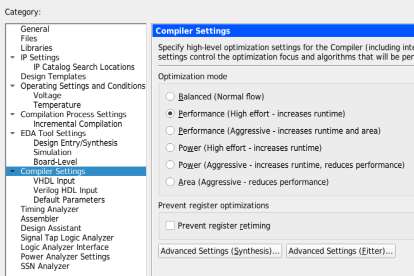

      And also set the Compiler setting to Performance:
      And Optimization Technique to Speed in Advanced Settings (Synthesis):
