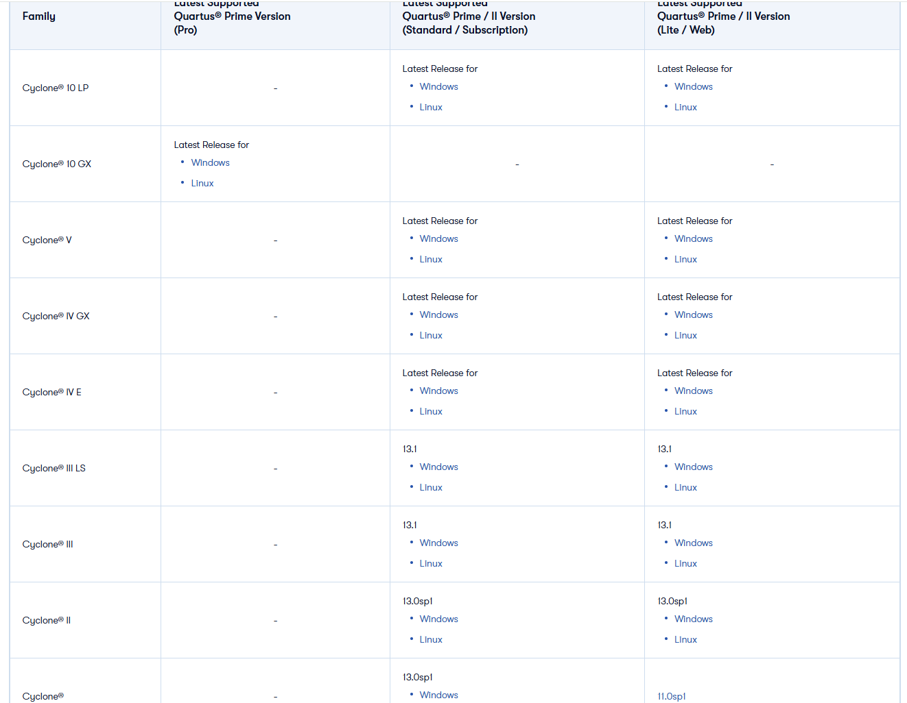

    As mentioned by FvM, Quartus II 13.0 Subscription Edition requires a valid Quartus II Subscription Edition license.
    Based on the device support information (https://www.altera.com/design/guidance/software/device-support), Cyclone® I devices are supported only in specific Quartus software editions and versions.
    You may consider one of the following options:
    1. Use Quartus II Web Edition 11.0 SP1, as suggested by FvM and jAlter. This version supports Cyclone I devices and does not require a paid subscription license.
    2. Purchase a Quartus II Subscription Edition license if you need to continue using Quartus II 13.0 Subscription Edition.
    Please review these options and select the one that best suits your requirements. If you have any questions, feel free to let us know. We will be happy to assist further.
