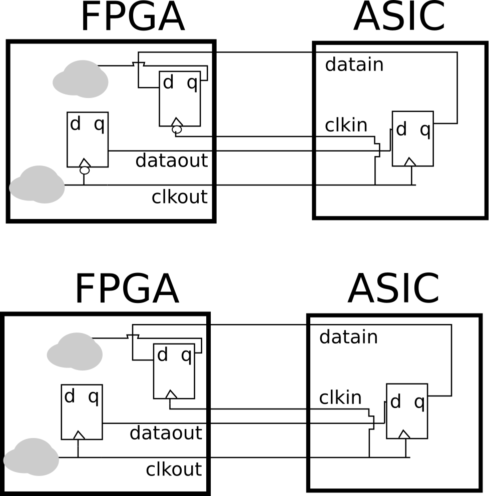

I have a question regarding the way the sdc timing constraints affect the design. Imagine a situation where we have a source synchronous design (both directions). FPGA drives flip-flop on the ASIC side, then ASIC propagates back both data and clock. Simple and standard situation.
I see two ways to handle it.
1) Send data on the falling edge, receive and latch with a rising edge on the ASIC side (so that we sample data in the middle) and then send back data to FPGA on the rising edge and sample there on the falling edge. Then we constrain the design even with a virtual clock, we kind of know that FPGA will receive data on a proper moment and sample it in the middle.

2) Second way. We always make a rising-edge latching, on both FPGA and ASIC side, but we need to constrain it properly. Making source synchronous constraining from FPGA to ASIC and ASIC to FPGA separately might be not enough if the paths on PCB/ASIC are not well balanced (so that data doesn't come in the same moment when clock changes or there is some clock skew/slew rate problem). So we can add dependency between the FPGA-ASIC clock (clockout) and clockin - jitter, delay, then latency for the data path.

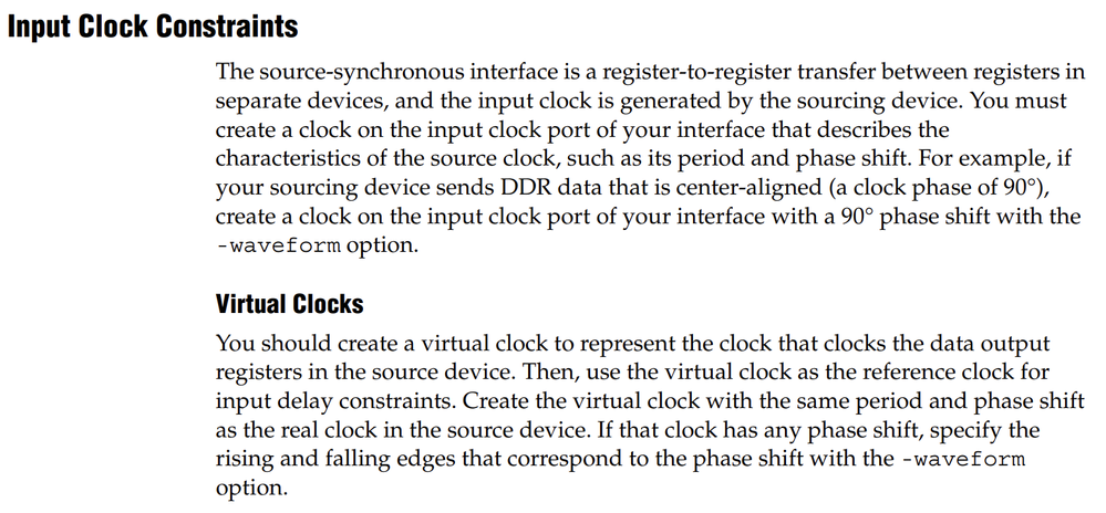

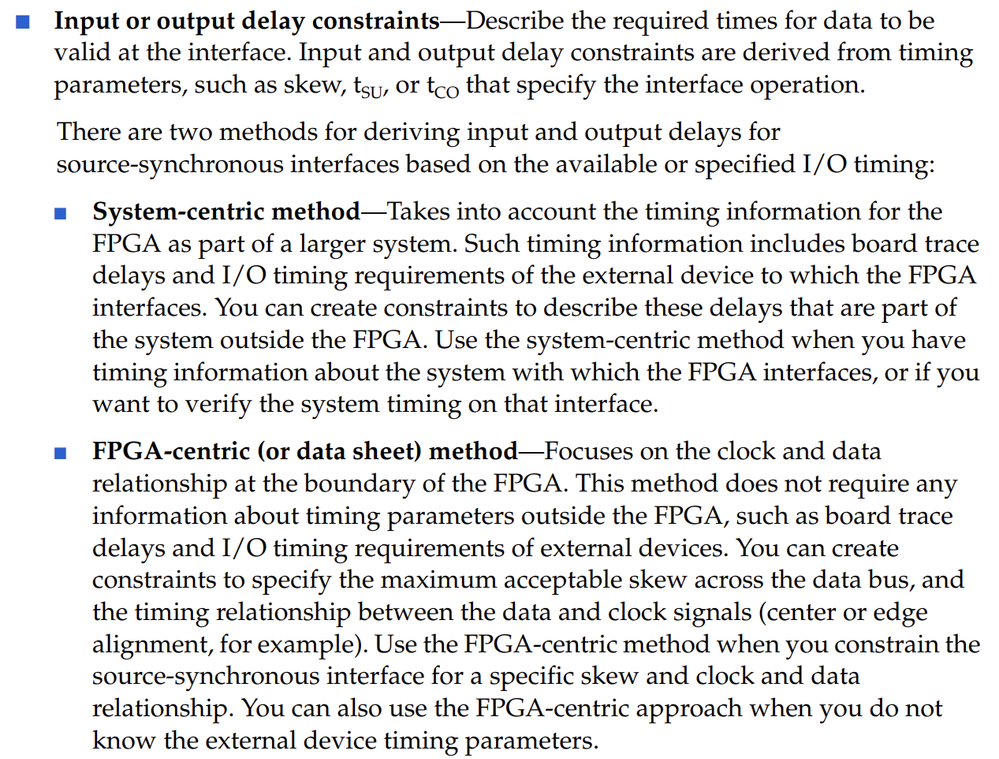

  • Perhaps sstrell could help to clarify more on your first question.
    Anyhow, we uses one of the two methods in deriving the input and output constraints for the SS.
    From what I see in the diagram, you may consider using the system-centric method.
    By specifying the appropriate clock waveform using the -waveform option, you can effectively align the clock edges to accommodate the data transfer requirements. Whether you choose center alignment or edge alignment depends on your specific design needs.
    You may checkout the "Clock and Data Relationship" section in AN433 and below screenshot.

      Thank you for your answers. I was just trying to figure out the 2) answer. Why the first way is incorrect? It's incorrect in the sense that the .sdc constraints are wrong or the general approach with rising-to-falling transition is wrong? In the end we have 2 source synchronous interfaces. I know I forgot to add the declaration of virtual clock clkin.
      Is 1) actually an answer to the above mentioned question? Do I understand correctly, the proposed center alignment information added in the clock declaration (-waveform ) should eliminate the clock_fall attribute. In the end the information about falling edge aligned data is synonymous to center rising edge aligned data.
      • RichardT_altera's avatar
        RichardT_altera
        Richard Tan

    To paraphrase, "There's an app [note] for that" as well as a training:
    https://www.intel.com/content/www/us/en/content-details/653688/an-433-constraining-and-analyzing-source-synchronous-interfaces.html
    https://learning.intel.com/developer/learn/courses/168/constraining-source-synchronous-interfaces
    Answering your questions:
    1) Clock latency constraints and generated clock for input clock are not needed. Just use create_clock for the virtual clock driven by the external device (launch edge) and for the clock arriving at the FPGA (latch edge), either center aligned or edge aligned using the -waveform option of create_clock. set_input_delay will refer to the virtual clock to select the launch edge clock and calculated max/min values will be based off info from external device (tco, setup/hold requirements, or skew). If tco is used, trace delay differences can be included in the calculation.
    2) Method 1 is not really correct for constraining an SS interface.
    3) Better idea would be to use the DDIO registers. Even if this is single data rate, you can tie the low data input to the high data input. The DDIO registers provide matching delay for the clock and data for both inputs and outputs.
    4) Not relevant if DDIO registers are used.
    5) Timing constraints guide the Fitter to meet the timing requirements you specify. Fine tuning may be possible in hardware for particular devices as you note, but it's not normally required. The constraints handle everything.
