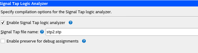

When I enable signal tab in Asembler.
I have problem when synthesizing
Error(17044): Illegal connection on I/O input buffer primitive dynamo_0|dynamo_0|phy_lite_dq|phylite_0|core|arch_inst|u_phylite_io_bufs|data_io_buf_gen_grp[0].data_io_ibuf_gen[0].u_twentynm_io_ibuf. Source I/O pin dynamo_0_conduit_end_dq[24] drives out to destinations other than the specified I/O input buffer primitive. Modify your design so the specified source I/O pin drives only the specified I/O input buffer primitive.
This error would not appear if I did not "enable signal tab logic analyzer"
Please help me fix this problem. Thank you very much.

I attached a screenshot below for you to take note on the postfitsignaltap. You should watch the video completely.

- sstrell
You are most likely tapping a post-fit node in your design that cannot be tapped. Look over the Node List in your Signal Tap file and see if you can tap either a pre-synthesis version of the node or another signal that feeds into the node you want to look at.
