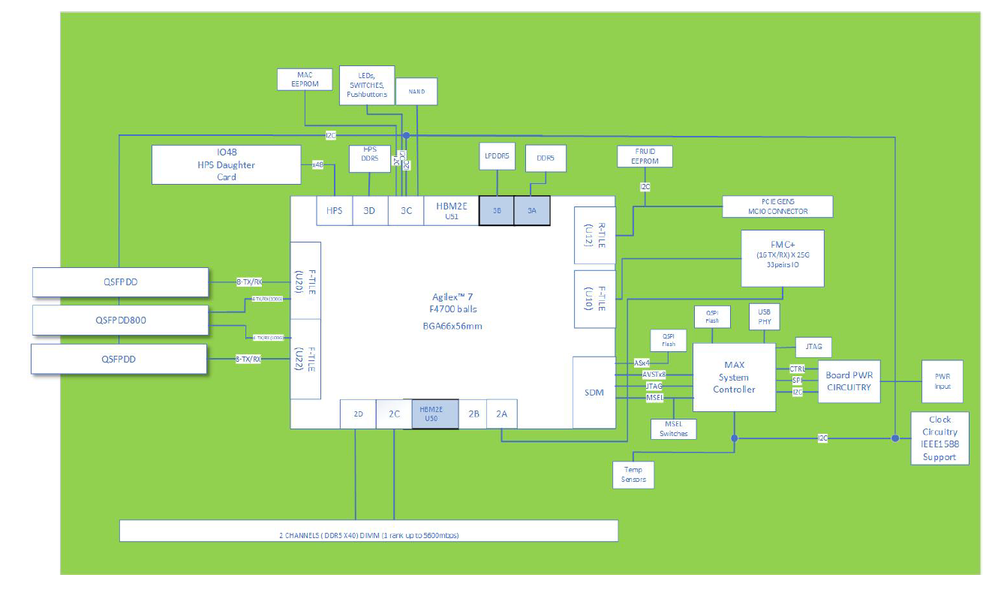

    • Thulasi's avatar
      Thulasi
      Please find the attached diagram based on Agilex M FPGA.
      We want to know the function of USB interface in this board. Any document giving the details would be great.

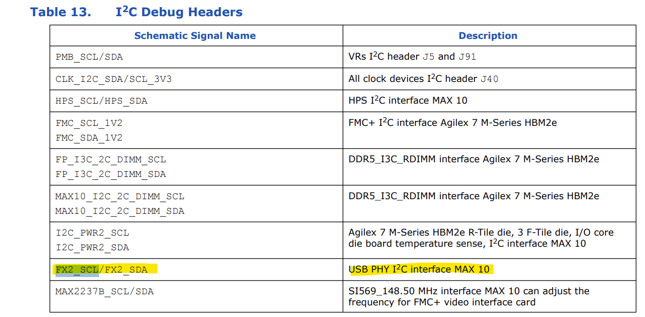

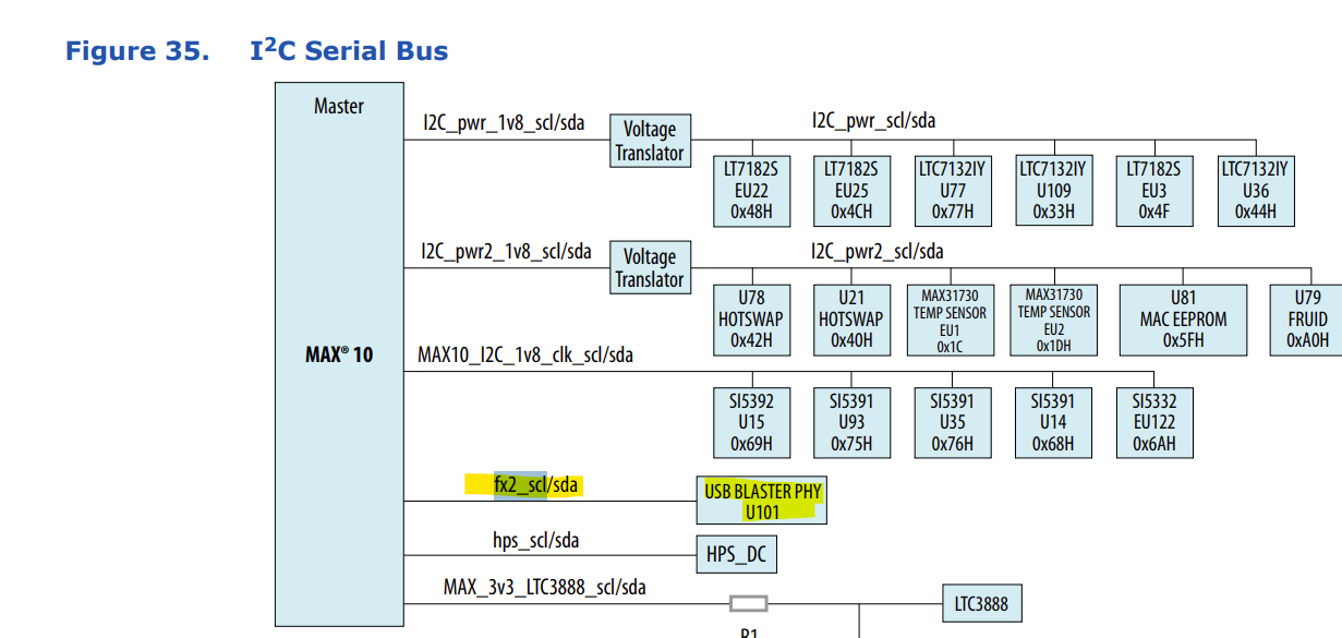

      • AqidAyman_Altera's avatar
        AqidAyman_Altera
        This is what I found in the Agilex 7 FPGA M-Series HBM2e Development Kit User Guide on the description of the signal connecting to this USB PHY.
