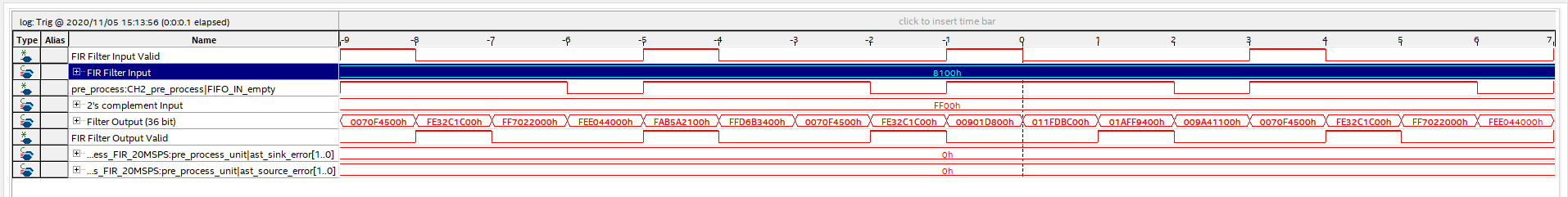

FIR II core IP outputs incorrect data.
It's my first time using intel's FIR filter IP and I'm having difficulties getting it working.
I basically want to low-pass filter the data coming from the ADC (LTC2387) using FIR II IP. The filter is fractional rate filter.
Here are some of the filter specs:
Input sampling rate: 15 MSPS
Filter clock : 60 MHz
Coeffs: 51 taps, 16-bit signed binary
Input 16-bit singed binary
Output: 36-bit signed binary.
The data coming from the ADC is in 2's complement, and therefore firstly I convert it to signed binary(bit magnitude) and feed the converted data to the filter's input.
To make sure that everything's working I make the input to the filter constant and observe the output, expecting that the output stays constant as well, but it doesn't.
The input is constant -256 (FF00h in 2s complement 8100h in signed magnitude) and the output looks quite random as you can see in the attachment.
I also attached the archieve file which include the filter I am using. The filter is in pre_process_20MSPS.vhd file along with the conversion from 2's comlement to singed magnitude process.
What am I doing wrong?

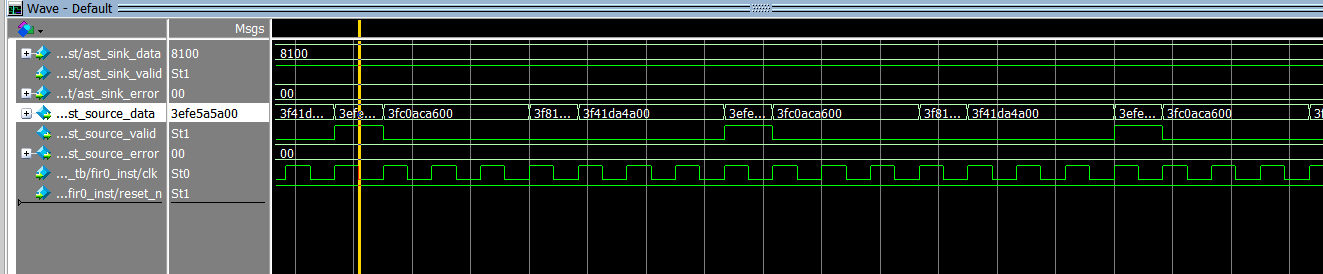

      Thank you for your kind response,
      OK I am going to start with a testbench, but I want to quickly confirm one thing. Is Singed binary same as bit magnitude where the first represents the sign and the rest is the number. I am talking about Input and output type in Input/Output Options settings.
      I wrote a simple test bench and tested the FIR filter (attached). I share the results with a screenshot. As you see the input is fixed at some value, the clock to the filter is 60 MHz and every fourth cycle of the I asserted the sink_valid signal for one cycle and I see don't see any output. No action from the filter.
      See the attached files for the test bench it's named FIR_tb.vhd. I know there is another tb file generated by quartus, but failed to get it working. I simply instantianted pre_process_FIR_20MSPS_0002 IP and tried to get it working.
      FIR_tb.vhd
      Thanks in advance.

      Thank you for your answer,
      I am observing the output of the FIR filter (FIR filter output (36 bit data)) in signal tap, so it's not modelsim simulation, it's real hardware implementation. Signal Tap file is also included in the .qar file that I shared.
      I understand that the file I shared is kind of complicated it's a portion of our design we working on I am sorry for its messiness. I kindly ask you to inspect pre_process IP. I t includes the FIR filter and data conversion(2's complement to bit magnitude conversion for the input).
      This is my understanding on how the IP works:
      I only need a signle channel therefore the error signals kind of irrelevant (no SOP or EOP), therefore I ignored them left them 'open' in the VHDL file. Sink side has an error input I don't know what to do with that. The input is 16-bit signed binary, I assume this bit magnitude form where the first bit is the sign and the rest is the number. The input 15MSPS, the output 20MSPS, the clock to the filter is 60MHz. What I do is I fixed the input signal at 0x8100 and assert sink valid at every 4th(60MHz/15MSPS = 4) cycle of the clock and expect the source valid to be asserted at every third cycle of the clock which is what we see in the waveform that I attached, but the output looks completely random.
