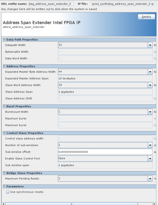

    Can you provide Address Span Extender IP setting?

      Yes I can trace the signal. I was looking at the AXI4 subordinate on the NoC initiator and I can see the JTAG requests reach that point. For addresses 0x0000-0x7FFF it appears to read just fine, data comes back and rresp is 0x0. However, when reading address 0x8000 rresp changes to 0x2 (SLVERR). Please see address span extender IP configuration in the screenshot below. This should allow me to access 0x0000_0000 - 0x7FFF_FFFF from the JTAG.
