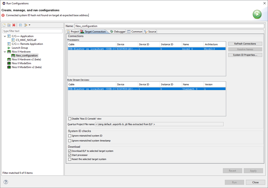

Then we removed on-chip memory and tried running simple hello world. I should also confirm that SGDMAs removed from design to simplify the design. however, when we are trying to start the NIOS, the error message pops out saying “Connected system ID hash not found on target at expected base address.” I know when this happens , there might be something wrong with system. However, we are yet unable to find the issue.

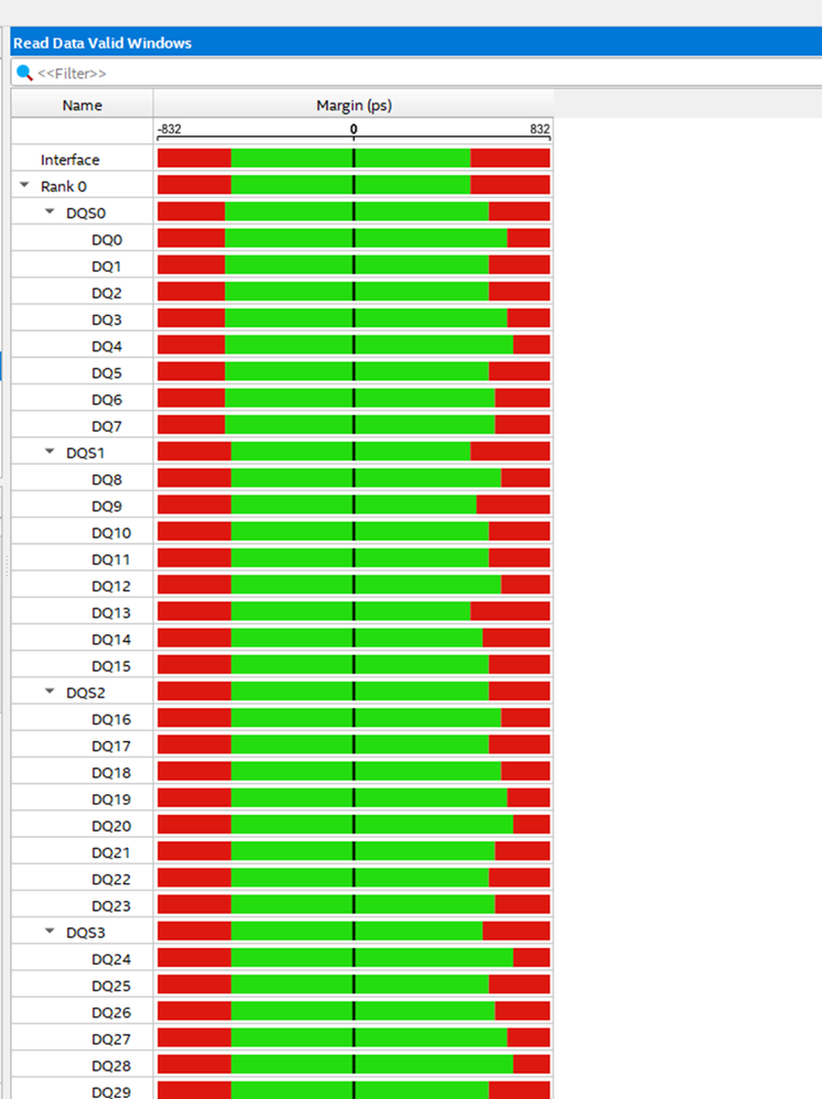

I should say that HMC core passes the calibration margins. Please see attached. DDR3 using single 32 bit bidirectional port avl_0 and both NIOS data master and instruction master connected to it. exception and reset vectors correctly set and NIOS alongside other peripherals running at 50MHz. any help appreciated. I should also mention that, when we change the ip core to soft memory controller system works fine.

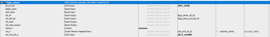

- Aidin-P2D
Thanks Kelly,

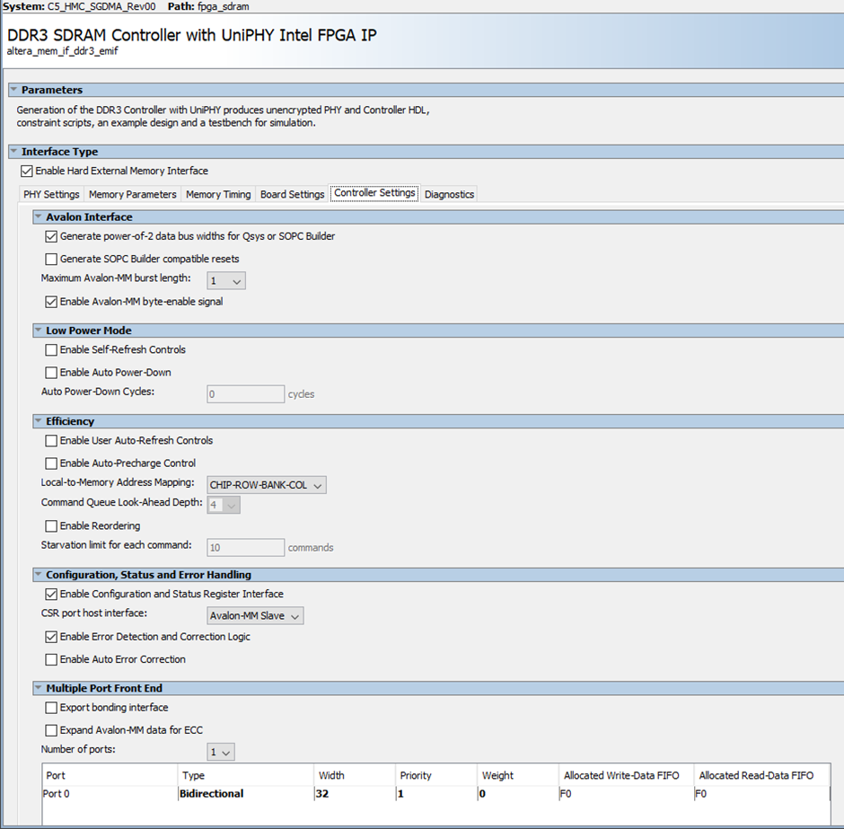

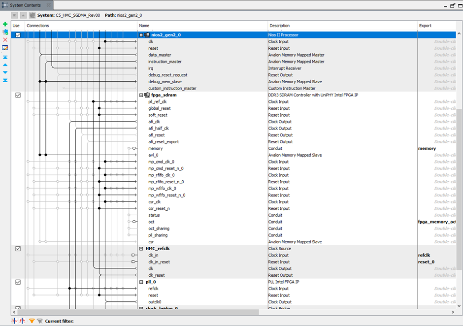

something is not adding up here . data sheet says 256MB however, Nios and Platform designer see the memory size of 512MB? could this be a problem? see below from platform designer?

Mind if I ask did you managed to programmed the correct sof successfully? Which quartus version are you using?
Would suggest on the following, check on the system.h files in BPS project to ensure system ID peripheral are listed with correct value, followed by regenerating the BSP to see if that helps.
As running the program in hardware, try to refresh the connection under 'Target Connections' tab.
You may also try checking 'Ignore mismatched system ID & timestamp' fields and run to the program to see if that helps.

Thanks for your reply. yes, I can confirm that we programmed correct .SOF. I am using Q22.1 10/25/2022 Lite edition
Reference system.h , I can also confirm that all values correctly set. refresh connection also done but no luck. when we are checking 'Ignore mismatched system ID & timestamp' fields, it shows a classic error "Downloading ELF Process failed".

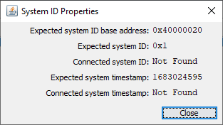

please see below system ID properties. interestingly, connected system ID and timestamp not found. I don't understand why connecting Nios II instruction master to HMC, can cause this issue.

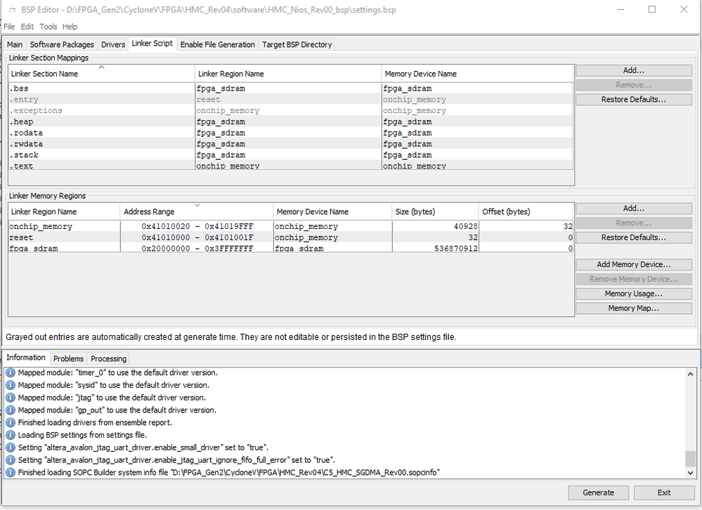

I managed to test your suggested workaround and we could get the timing closures by reducing the frequency to 320Mhz and changing speed grade to 8. however, the problem is still there and Nios is not functioning when connecting Nios instruction master to HMC. we did implement on chip memory and nios vectors set to that memory. on BSP editor -linker script we selected .text to be onchip memory and the rest to be fpga_sdram which is HMC. system works fine with no issues. Array of 400MB defined and filled with data and verified. so the question remains why Nios system is unable to boot up/function when instruction master connected to HMC. it appears that connection brings the whole system down. any thoughts ?
