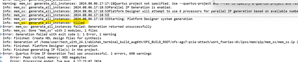

    Just an update on my side, I've rebuild flat HE null again and the dk flat with no issues
    i) ./ofs-common/scripts/common/syn/build_top.sh --ofss tools/ofss_config/fseries-dk.ofss fseries-dk:flat,null_he_lb,null_he_hssi,null_he_mem,null_he_mem_tg work_fseries-dk_flat
    ii) ./ofs-common/scripts/common/syn/build_top.sh fseries-dk work_fseries-dk
    I was searching our database to see any reported issues, so far didn't find any reported cases that relates to the issue directly except there is one case that has the same failure but it was trying to access example design stored remotely in server during testing. Also did not see any known issues with the release that related to this error
    Error: generate_all_instances : INTERNALstill running after destroy
    Error: UNAVAILABLE: Network closed for unknown reason
    Could you check your Quartus license whether the license is activated (one brief comment was that the issue was due to licensing for access which i doubt in this case as you're building files locally)
    May I know your kernel version as well (uname -a )?
    I notice the "Info: mem_ss: Done "mem_ss" with 2 modules, 1 files" , on my side it should have more modules and files, not 1 file.
    Attached is my build logs as well for reference

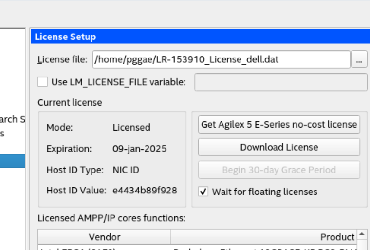

    • Md_Raizz's avatar
      Md_Raizz
      Hi Kian,
      Thank you for your response, and I apologize for the delay.
      I have checked that the license is activated in Quartus, and my kernel version is 6.1.41-dfl.
      Please refer to the image below for your reference.
      Thanks and Regards,
      Raizz

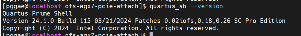

    https://github.com/OFS/ofs-agx7-pcie-attach/releases/tag/ofs-2024.2-1
    You should get 0.02iofs , 0.18 and 0.26 patches when you check the version "quartus_sh --version"
    Could you download and install those patches first and rerun the FIM generation?
    Kian

      Hi Kian,
      Thanks for your update.
      I completed the patch installation of IOFS based on your previous reply and have started the FIM generation. However, I'm still facing some errors during compilation. I’ve attached the logs for your reference.

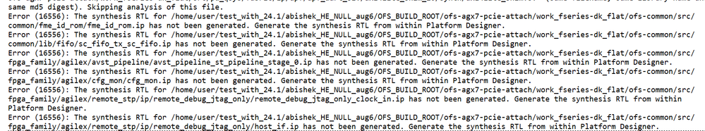

    Sorry for the delay in replying, was setting up another server to duplicate via Centos to imitate Redhat environment, was EOL recently so had to reconfigure certain settings to build FIM again. Currently still in process of generating to try to duplicate the same issue.

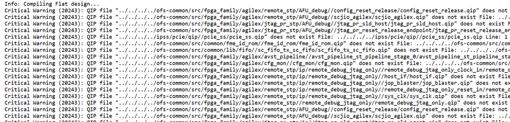

    Anyway on the log side, I saw dk-flat and he null dk-flat having the same issues, which is complaining on the files missing which is odd. It was not part of the github repository thus I'm assuming it should be generated out, had alot of critical warnings on file missing which eventually leads to error.
    Whereas on the fseries-dk.log , seems like the process is killed early thus resulting in error

    Sorry for the wait, was setting up the server on ubuntu with the relevant Quartus and OFS version. I've tested 3 times and unfortunately I don't see the "hang" part though, the part where it "hangs" passes without issue on my side although on the particular FIM version 2023.3 do have compilation error at later stage (seems mentioned in release notes)
    From your log
    On my side
    but eventually compilation will fail with error (after around 1hour + into the compilation, average it will take around 7-8 hours on my system on Xeon processor)
    might be due to this
    I will check with OFS team on this but I think the main focus is getting the compilation to work ,so probably will focus on 'freeze/hang' at the qsys-generate.
    When you mentioned stuck for hours, may i know like the exact/estimate time on how long like how many hours? I'm wondering whether to leave it much longer and see whether the qsys-generate will complete (it is depending on processor type on how long the duration)

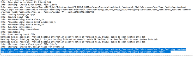

    I saw the log that you provided, looks like the compilation just stalled at that location and seems to be truncated/incomplete (eg sudden stalled) without error
    Info: qsys-generate /home/admin/SmartNIC/Intel/Intel-agilex/OFS_BUILD_ROOT/ofs-agx7-pcie-attach/work_fseries-dk_flat/ofs-common/src/fpga_family/agilex/hps/hps_ss.qsys --synthesis=VERILOG --output-directory=/home/admin/SmartNIC/Intel/Intel-agilex/OFS_BUILD_ROOT/ofs-agx7-pcie-attach/work_fseri
