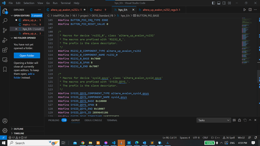

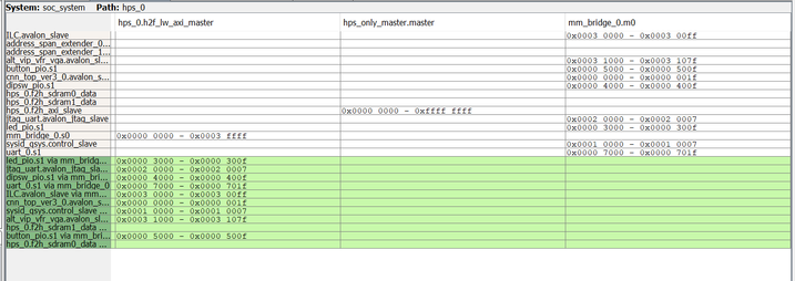

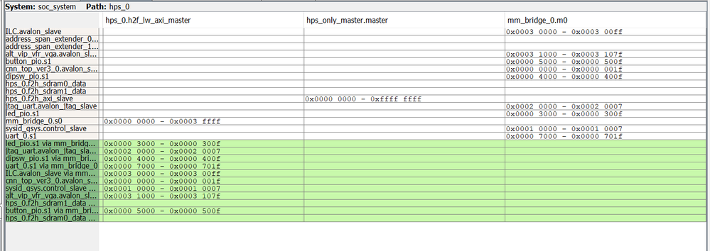

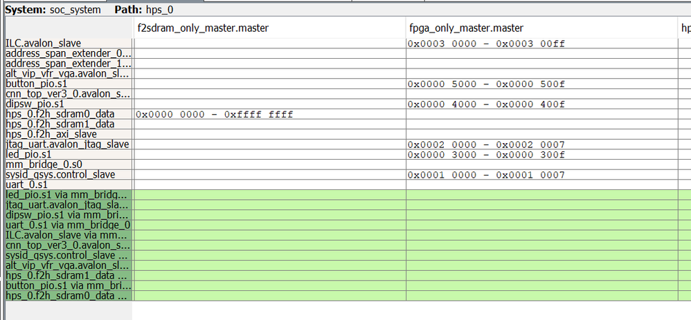

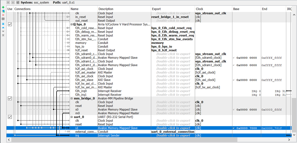

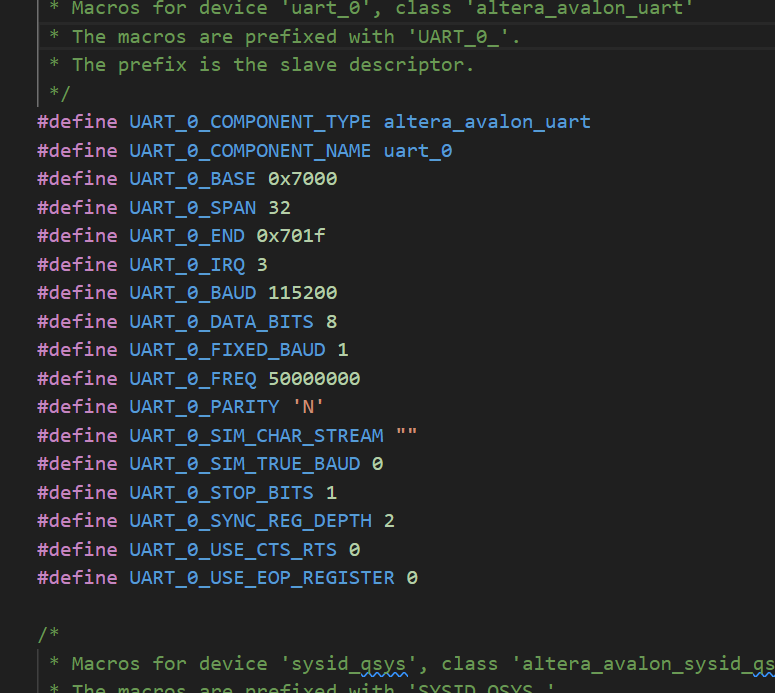

From the address map I see that UART IP is connected to the light-weight F2H and an offset of 0x7000.
The LWF2H start address is 0xFF200000.
Could you try accessing the address 0xFF207000 as your h2p_lw_uart_addr?

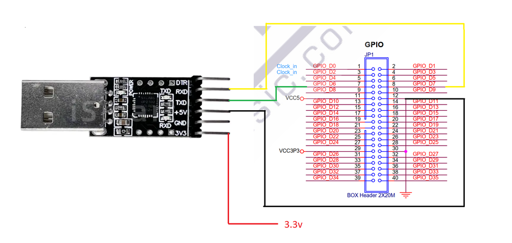

1. Connect hardware:
Connect hardware (1)Connect hardware (2)data received from CP2102 displayed on hercules terminal

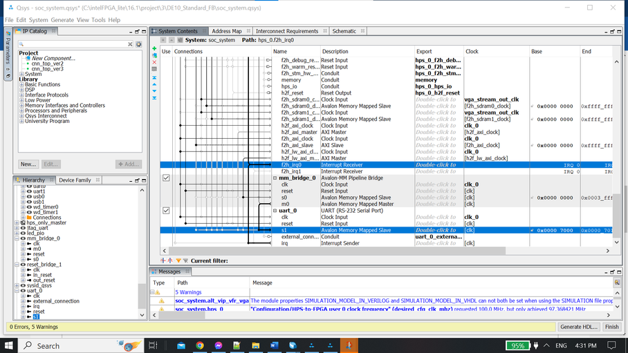

2. Add ip into GHRD project
Qsys connectionconfigure IP uart
address map (1)address map (2)address map (3)

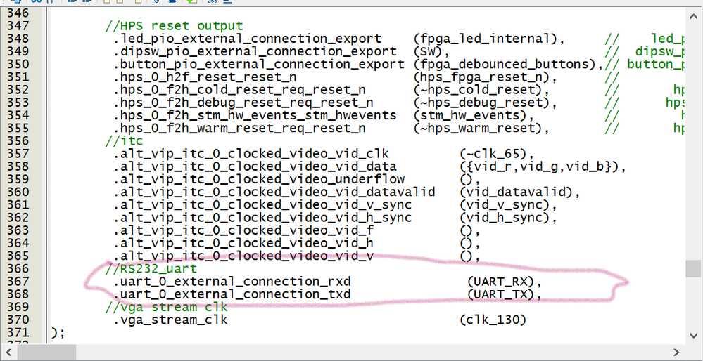

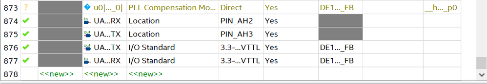

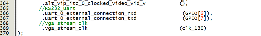

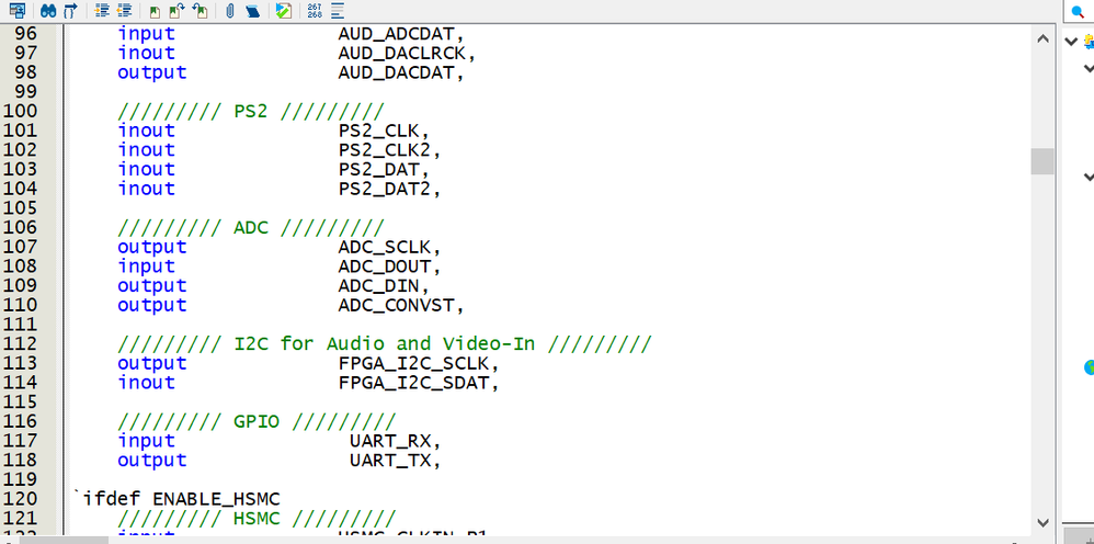

3.Assignments pin
File top.v(1)File top.v(2) Assignments pin (GPIO 6 - RX, GPIO7-TX)

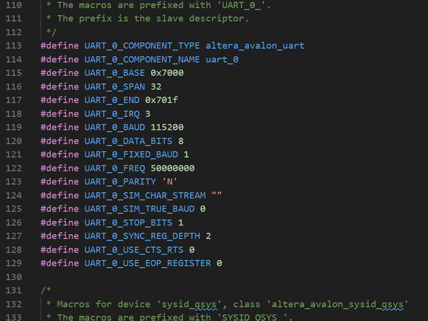

4. File hex use for code C
Define for IP UART

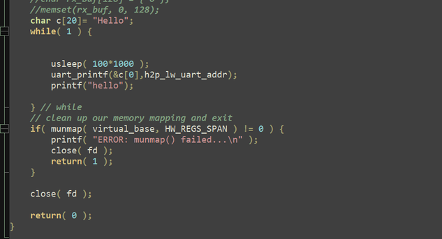

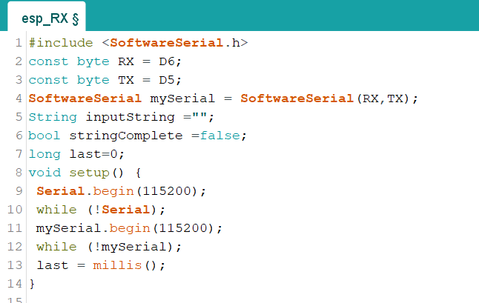

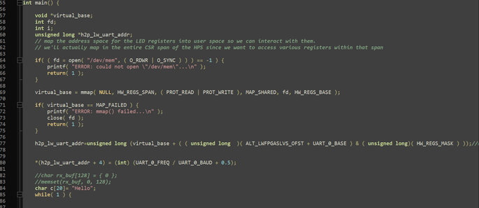

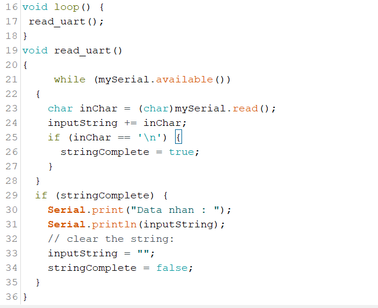

Sorry i had a important update with all image. You will follow new image i update and I don't know why my code is like this but esp8266 doesn't receive data? You help me check it. Thank you very much for your help.
QSYSadd external port for uart rs232 serial portcode rx for esp8266 (1)code rx for esp8266 (2)file hex contain UART_0_BASEcode tx for de10 (1)code tx for de10(2)code tx for de10 (3)

What error are you experiencing when running the code on the HPS?
Can you please share the run logs for the code in the HPS.

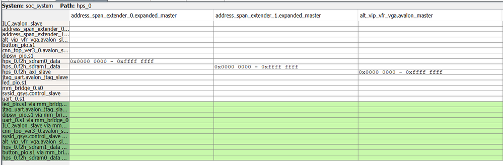

Could you share a screenshot of your Address Map in Qsys?
I think it could be related to the address value that you set for the uart.
Could you print out what is the exact value of h2p_lw_uart_addr?

- Alen1214
Thank a lot Jingyang, Teh.
when running the core on the HPS, I has no error and in terminal has a long string "hello hello ...." but ESP8266 is not getting any character.
Then I share with you some screenshot of your Address Map in QsysAddress map in Qsys (1)Address map in Qsys (2)Address map in Qsys (3)
I will print out the exact address value of h2p_lw_uart_addr as soon as I can. And I hope you check for me with some information I provided.

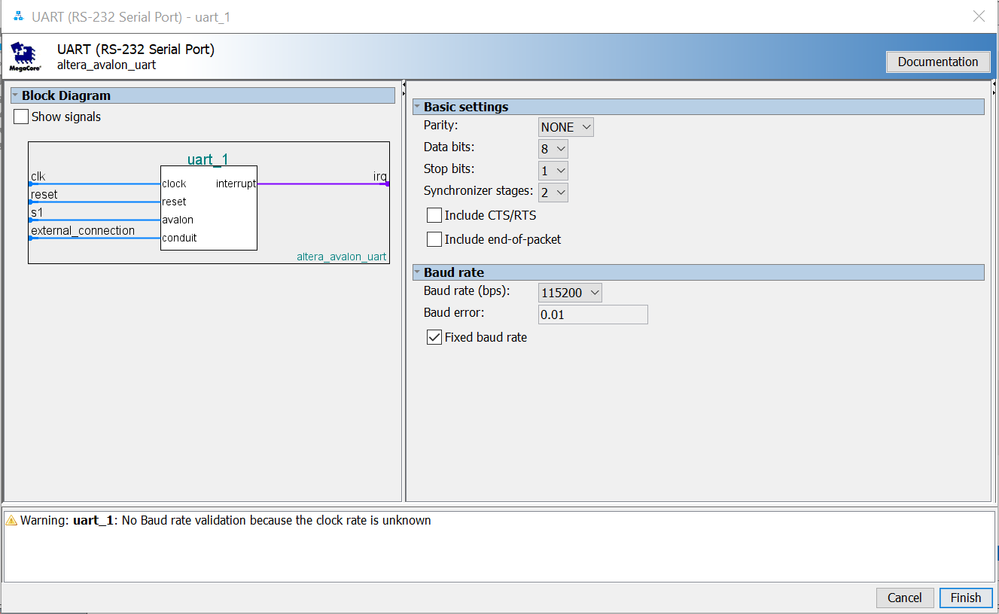

For the baud rate settings, you do not need to write to the divisor register as you have selected "Fixed Baudrate" in the IP Configuration.
Writing to the divisor register as no effect.
Gone through the code that you shared, it looks fine with all the condition checking before sending.
One thing I can think of is the stop bit settings. The tool that you are using to write and read from the UART does not have a settings to set the Stop bits.
Could you try with another tool such as Putty? In putty there is a Stop bits settings, with that set the Stop bit to 1 same as the IP configuration.

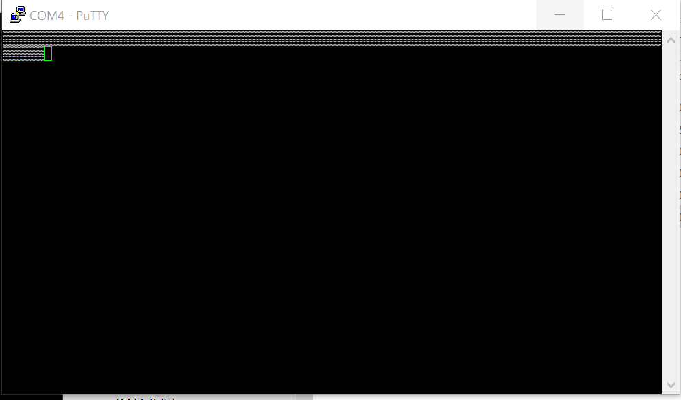

- Alen1214

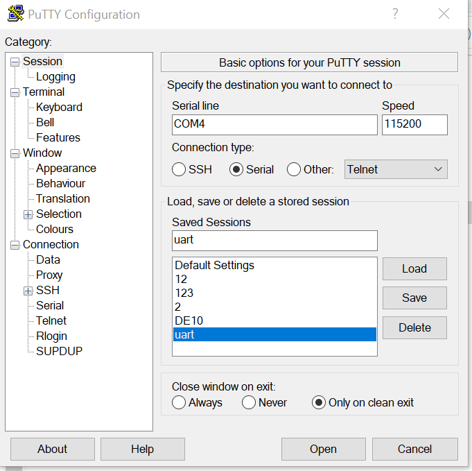

hi,I have tried using putty but it's not correct.
puttyputtyterminal
