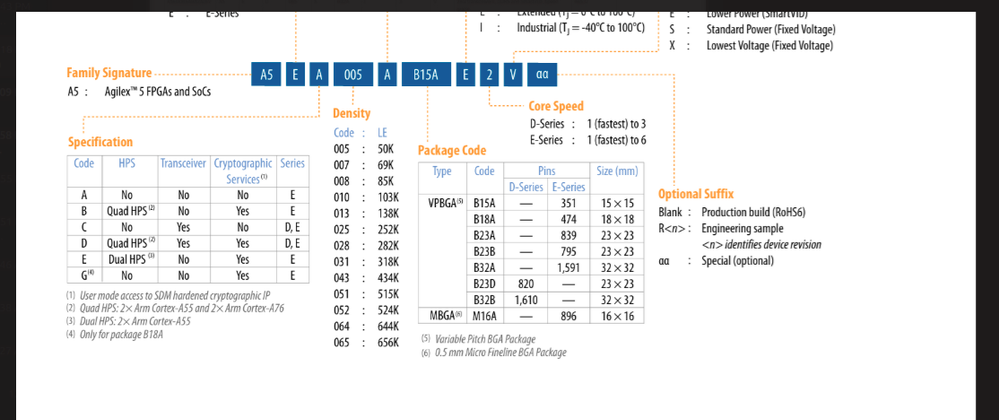

Thanks, I have a question regarding part numbers because I feel I'm kinda lost.
I have the following devkit: MK-A5E065BB32AES1 which according to this document https://cdrdv2-public.intel.com/820978/ug-820977-820978.pdf uses the following part number: A5ED065BB32AE6SR0
Looking at the table in Security Overview it seems that variant "D" should feature the CryptographicServices.
Also I found the following table that also states that it should feature Quad HPS and CryptographicServices.
Am I right? Does my devkit have the Cryptographic services?Also how about:
- A5EC065BB32AE6S
- A5EB013BB23BE4SCS https://www.terasic.com.tw/cgi-bin/page/archive.pl?Language=English&CategoryNo=123&No=1384&PartNo=2#contents
Do they have crypto_services?
Will be grateful for some information.
