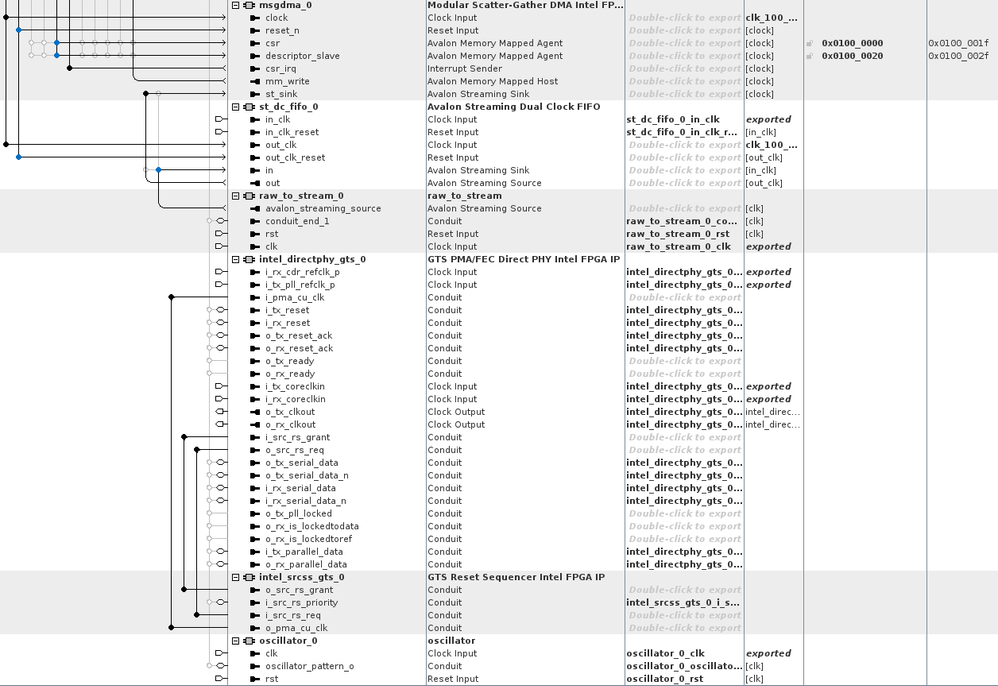

The Qsys diagram looks as followed (HPS section omitted for brevity):
It's also worth noting that the Osc -> FIFO -> DMA-> HPS design has been tested and works ok.

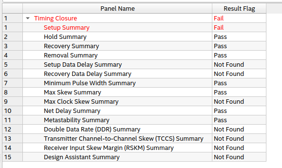

I have compiled two different designs:
1: Reduced test
Clock domain A: Oscillator -> GTS -x
Clock domain B: 32'b1 -> FIFO -> DMA -> HPS

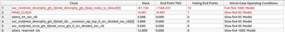

The STA output:

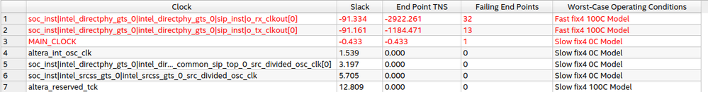

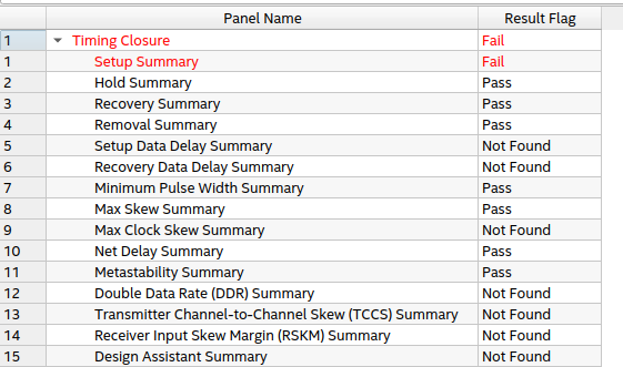

The STA output:
