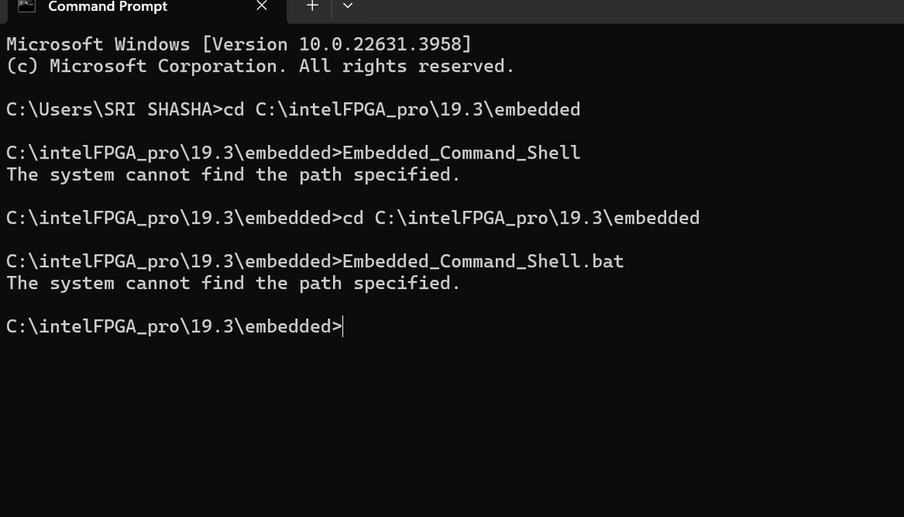

I have installed Quartus Prime software v24.1. I need to run embedded command shell in the Intel SoC Embedded Design Suite(EDS) Professional Edition version 19.3. After installation of the both softwares . I am unable to execute the embedded command shell.bat file.
Is this due to version change in two installed softwares?
The following image shows the error message appearing in the windows command prompt.
Thank you
The last SoCEDS embedded command shell is only available with the quartus v2020.1.
https://www.rocketboards.org/foswiki/Documentation/SoCEDS
SoCEDS is EoL-ed from Intel-Altera in 2020. So there will be very less or no support from the us. Please refer the updated HWLIB Github-https://www.rocketboards.org/foswiki/Documentation/HWLib
If you are using the Quartus v24.1, then you need to have separate ARM DS tool and it doesn't need soceds embedded command shell to run.

Thank you for the reply. The above reply solved our issue.
