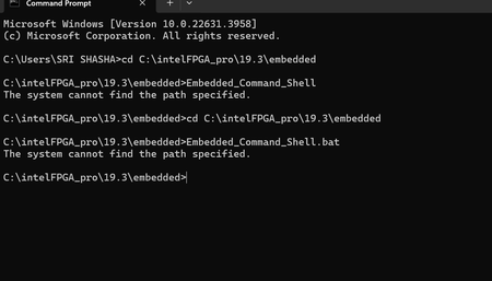

Unable to run Embedded Command Shell v19.3
- 1 year ago
The last SoCEDS embedded command shell is only available with the quartus v2020.1.
https://www.rocketboards.org/foswiki/Documentation/SoCEDS
SoCEDS is EoL-ed from Intel-Altera in 2020. So there will be very less or no support from the us. Please refer the updated HWLIB Github-https://www.rocketboards.org/foswiki/Documentation/HWLib
If you are using the Quartus v24.1, then you need to have separate ARM DS tool and it doesn't need soceds embedded command shell to run.
