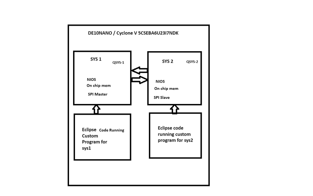

is it possible create a two qsys system (see below system image) with following system components on one fpga?
sys1 components: nios ii, onchip mem, spi 3 wire (config as master)
sys2 components: nios ii, onchip mem, spi 3 wire (config as slave)
and have separate eclipse code for sys1 and sys2.
i would like to test this in my DE10 NANO board.
i want this setup as a testbench to test my SPI master / slave communication code without buying a another DE10 nano.
if its possible, please give me some examples or tutorial link.
Multi-Nios core processor is possible check this design example link https://www.intel.com/content/www/us/en/support/programmable/support-resources/design-examples/horizontal/exm-multi-nios2-hardware.html
and pdf link http://www.ee.nmt.edu/~erives/554_10/Altera_Multiprocessors.pdf
